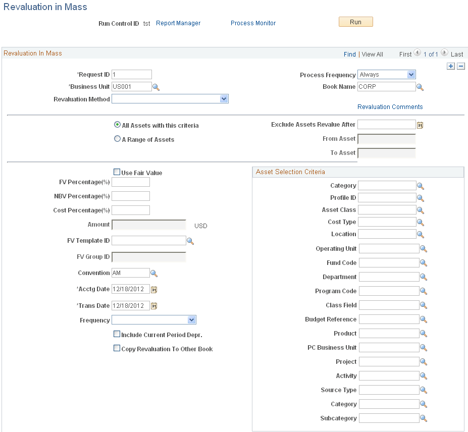

Use the Revaluation en Masse page (AMREVAL_RQST) to run a process to revalue, at once, all assets that meet the criteria that you specify.
This process loads the interface tables and updates the FV table if applicable; you must then use the Transaction Loader to populate all the asset tables.
Navigation:
This example illustrates the fields and controls on the Revaluation en Masse page. You can find definitions for the fields and controls later on this page.
