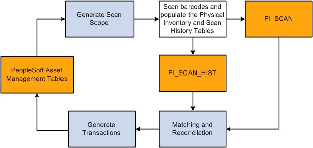

The mobile physical inventory method enables you to scan assets, retrieve and display real-time asset information from the Asset Repository, and automatically populate the Physical Inventory (PI_SCAN) interface and Scan History (PI_SCAN_HIST) tables with scan records—all from your mobile scanning device and without the use of a third party scanning solution. The classic physical inventory method requires a third party scanning solution and necessitates that you use flat files to populate the Physical Inventory interface table with scan records.
The mobile physical inventory method automatically maintains asset scan history in the Scan History (PI_SCAN_HIST) table. When an asset or tag is scanned, this table records the date and time it was scanned. If an asset is scanned again, another record is inserted into the table. The previous record remains to provide a history. The Scan History table is not used with the classic physical inventory method.

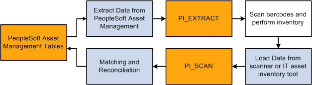

The classic physical inventory method requires you to extract assets and generate an extract file, then load the scan file back into Asset Management to create a set of all assets that you might scan during a physical inventory. However, with the mobile physical inventory method you can simply run the Generate Scan Scope process to create a list of assets that you expect to scan. With the Generate Scan Scope process, if an asset is scanned and not found in the Scan Scope, the asset is automatically retrieved directly from the Asset Repository.
Because the mobile physical inventory method does not require flat file downloads and uploads, or an extract scope, there are fewer processing steps than the classic method.
The following diagrams provide a high–level process flow of the two physical inventory methods:
The following diagram illustrates the Classic physical inventory method.
The following diagram illustrates the Mobile physical inventory method

Follow these steps to perform mobile physical inventory:
Set up and configure physical inventory per your requirements.
Set up scan scope parameters and run the Generate Scan Scope (AMPI1000) process. The Generate Scan Scope process automatically defines a set of assets that should be scanned and enables that information to be discoverable by your scanning device.
Note: You do not need to manually populate the PI_EXTACT table, create an extract file, and load the file into a scanning device.
See:
Defining the Extract Scope, the Scan Scope, and the Physical Inventory Parameters
Load/Match/Reconcile PI Info Page (Mobile Physical Inventory)
Perform barcode scanning in combination with the Physical Inventory tile in the PeopleSoft Fluid User Interface; this populates the Physical Inventory (PI_SCAN) and Scan History (PI_SCAN_HIST) tables with scan records.
Run the Generate Results (AMPI1000) process to perform scan scope/scanned data matching and generate physical inventory results for review.
Run the Generate Transactions (AMPI1000) process to move transactions from the PI_SCAN interface table to Asset Management tables.
Run the Delete Data (AMPI1000) process to delete physical inventory transactions, physical inventory results, and physical inventory scanned asset data when you no longer need them.

For classic physical inventory processing, suppose that you are inventorying computer equipment. An IT discovery tool obtains the physical attributes of a workstation, along with the amount of installed memory, the type of monitor, the amount of free hard disk space, and the installed software on the computer. You then load physical inventory data and the physical information gathered by the discovery tool software into Asset Management. The physical inventory processing determines the assets that have been added, transferred, or retired. Using these results, you perform matching and generate transactions to reconcile the data in Asset Management with the results of the physical inventory.
Classic Physical Inventory Processing
These are the steps to process classic physical inventory:
(Optional) Extract physical inventory asset data from PeopleSoft Asset Management.
PeopleSoft Asset Management provides a physical inventory system that enables you to extract asset data from the PeopleSoft Asset Management database into a sequential file and then load it into a bar code scanning device. You can also extract data from third-party information technology (IT) asset discovery tools. Such discovery tools belong to a class of software that you can use instead of bar coding for laptops, computers, and other IT equipment. These discovery tools poll the assets over a network and update a central database.
(Optional) Use the extracted physical inventory data to generate a sequential file or Excel Comma Separated Value (CSV) file that a bar code scanner or inventory device can use, and enter the file into the scanner.
Steps 1 and 2 are necessary only if you want to display data from your PeopleSoft Asset Management database as you scan each asset. The displayed information can include asset IDs, tag numbers, serial numbers, manufacturers, models, descriptions, departments, locations, and so forth. This asset data can provide instant information about an asset's history.
After you scan assets, load the scanned data into PeopleSoft Asset Management and resolve any duplicate tag numbers and serial numbers.
After you match the physical inventory scan scope to the scanned data, generate physical inventory results for review.
Generate transactions based on the results.
You then load the transactions to reconcile the data in PeopleSoft Asset Management with the physical inventory results.
Delete the physical inventory transactions, physical inventory results, and physical inventory scanned asset data when you no longer need them.
(Optional) If you created an extract file, delete that file when you no longer need it.
