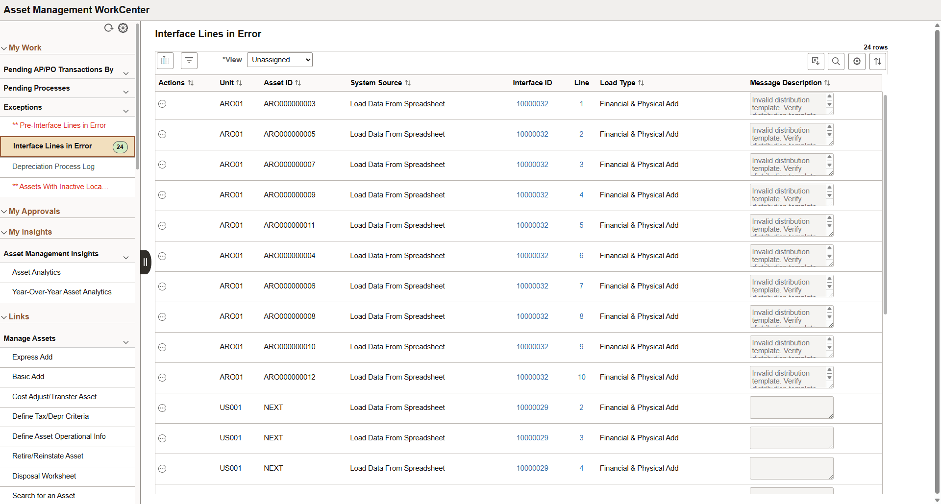

This example illustrates the fields and controls on the Asset Management WorkCenter - Interface Lines in Error page when using Work Management.
Asset Management WorkCenter - Interface Lines in Error (Work Management)
description
When Work Management is enabled for an exception, there are two changes on the WorkCenter page:
  • The View drop-down box appears above the grid.
  • Additional action options are added to the Actions button.
    The original action options remain. The additional (Work Management) action options depend on the View option selected.
The initial actions for Interface Lines in Error are Reset Transactions To Pending, Change to On-Hold, and Change to Excluded. When Work Management is enabled, additional actions are available depending on the option selected in the View field: See Understanding the Work Management Framework, Actions by View section.
