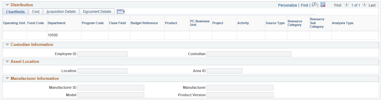

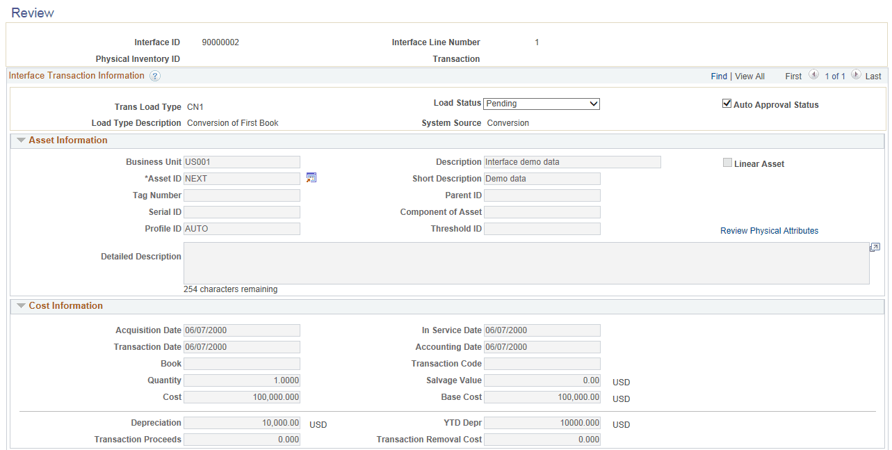

This example illustrates the fields and controls on the Review Page (1 of 2). You can find definitions for the fields and controls later on this page.
This example illustrates the fields and controls on the Review Page (2 of 2). You can find definitions for the fields and controls later on this page.
If the Load Type has changed because of an Asset Id change, a Warning icon will appear next to the Load Type to let the user know the actions they performed caused a change in the Load Type.
Note: The fields will be available for editing based on the interface type, load status and User Preferences.

Load Status |
Displays the load status associated with the Interface ID. The load status can be the following values:
Auto Approval Status |
Select the check box for the Transaction Loader (AMIF1000) to process the transaction. |
Review Physical Attributes |
Click this link to review the physical attributes. Review Physical Attributes link is available only if the transaction has Physical B information. |
