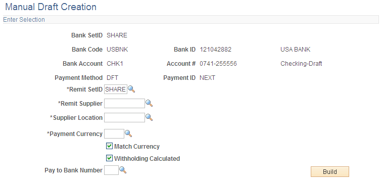

Use the Manual Draft Creation page (APD_MANDFT_SEL) to manually create customer-initiated or supplier-initiated drafts.
Navigation:
This example illustrates the fields and controls on the Manual Draft Creation page. You can find definitions for the fields and controls later on this page.
Enter the bank code and account information.
Field or Control |
Description |
Remit SetID, Remit Supplier, and Supplier Location |
Enter the SetID, remit supplier ID, and supplier location for the supplier to whom you remit the manual payment. When you build the worksheet, the system returns eligible scheduled payments with the same supplier information. Note: If financial sanctions validation is enabled and the supplier has a financial sanctions status of Review or Blocked, the system displays a warning that the supplier selected is currently under financial sanctions review and vouchers for this supplier cannot be applied against a manual draft. |
Payment Currency |
Displays the payment currency for the draft payment. |
Match Currency |
Select this option to return scheduled payments with the same payment currency. If you do not select this option, the system returns all eligible scheduled payments for the remit supplier, regardless of their payment currency, and converts them to the selected supplier's currency. |
Withholding Calculated |
Select return only those vouchers for the remit supplier that have had withholding calculated—that is, those vouchers for which withholding has been calculated at voucher posting time and that have been posted. If this check box is deselected, all vouchers for the remit supplier are available on the manual draft worksheet, excluding vouchers that are set to have withholding calculated at voucher posting and that have not yet been posted. The Withholding tab of the Manual Draft Entry - Manual Draft Apply page displays two flags indicating whether the voucher is withholding-applicable and whether withholding has been calculated. |
Pay to Bank Number |
Specify the bank to which the draft payment is made. The pay-to bank number is used as one of the matching criteria for the scheduled payments that you apply to the draft payment. Only those scheduled payments that have the specified pay-to bank number appear when you click the Build button. The value in the Pay to Bank Number field is a system-created value that is associated with each supplier bank account that you define on the Supplier Bank Account page. |
Build |
Click to create a temporary worksheet for the manual draft payment, based on the remit supplier, supplier location, and payment currency that you specify. Assign a draft worksheet ID search for scheduled payments that match the specified criteria. The system displays the Manual Draft Entry page, where you can enter the payment amount, draft drawee, payment description, and draft maturity date. Note: If financial sanctions validation is enabled, the system validates the supplier against financial sanctions lists (for example, SDN list) when you click the Build button. The system updates the supplier's financial sanctions status on the Supplier Information component (VNDR_ID). The system does not allow you to build a draft worksheet for a supplier with a financial sanctions status of Review or Blocked. However, if financial sanctions validation is enabled at the bank level and you no longer validate a particular supplier's bank, the system may allow you to create a manual draft worksheet for a supplier with a financial sanctions status of Review. |
When you save manual drafts, the status of the draft varies depending on the values that you selected on the Payables Options - Payment Options page:
If you selected the Draft Issue Approval Required check box, the status of the manual draft is Approved.
If you did not select the Draft Issue Approval Required check box, the status of the manual draft is Created.
Note: After the system builds a draft worksheet, if you decide that you don't want to create the manual draft, you can remove the draft worksheet by using the Delete Worksheets page. You cannot delete a draft worksheet if you have applied scheduled payments to the manual draft and saved the draft worksheet. After you have applied scheduled payments to the manual draft, you can cancel the manual draft payment by using the Cancel Manual Draft page.

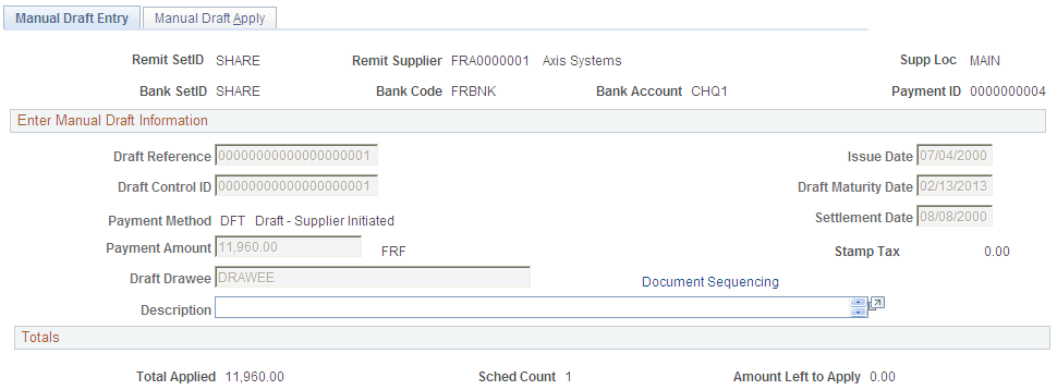

Use the Manual Draft Entry page (APD_MANDFT_ENTRY) to review drafts that you created on the Manual Draft Creation page.
If you click the Build button on the Manual Draft Creation page and save the worksheet without completing the draft information, you can use this page to edit or complete the manual draft payment information. If you previously created the draft payment, you cannot edit any of the draft payment information. In this circumstance, this page is for information only.
Navigation:
Click the Build button on the Manual Draft Creation page.
This example illustrates the fields and controls on the Manual Draft Entry page. You can find definitions for the fields and controls later on this page.
Enter the manual draft information.
Field or Control |
Description |
Issue Date |
Specify the draft issue date. The draft issue date is the same as the draft creation date. |
Payment Amount |
Enter the amount of the draft payment. The system displays the currency in which the draft payment is paid. This value derives from the supplier's bank account. You can specify a different currency on the Create Manual Draft page. |
Stamp Tax |
Displays the amount of any applicable stamp tax for the draft. |
Draft Drawee |
Enter the name of the entity to whom the draft payment is made. |
Totals
Field or Control |
Description |
Totals Applied |
Displays the amount of the payment applied to the draft. |
Sched Count (scheduled count) |
Displays the number of scheduled payments that apply to the payment. |
Amount Left to Apply |
Displays the payment amount remaining that is not applied to the draft payment. |

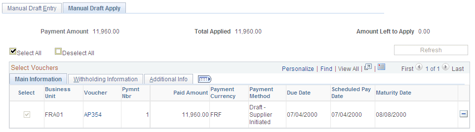

Use the Manual Draft Apply page (APD_MANDFT_APPLY) to apply vouchers to manual drafts.
Navigation:
This example illustrates the fields and controls on the Manual Draft Apply page. You can find definitions for the fields and controls later on this page.
Field or Control |
Description |
Payment Amount |
Displays the payment amount currently entered on the Manual Draft Entry worksheet page. |
Total Applied |
Displays the total amount of the scheduled payments currently applied to this manual draft. |
Displays the difference between the manual draft payment amount and the total amount of the applied scheduled payments. |
Refresh |
Click to apply the selected scheduled payments to the manual draft and recalculate the total applied amount and the amount left to apply. |
Note: Multiple views of this page are available by clicking the tabs in the scroll area.
Main Information
Select the Main Information tab.
Field or Control |
Description |
Select |
Select the check box next to vouchers that you want to include in the draft payment. Deselect the check box if you do not want the voucher to be included in the draft payment. |
Business Unit |
Displays the business unit for the scheduled payment. |
Voucher |
Displays the voucher ID of the selected payments. Click any of the voucher IDs listed to access the Voucher Inquiry page for that voucher. |
Pymnt Nbr (payment number) |
Displays the number of vouchers included in the scheduled payment. |
Paid Amount |
Displays the amount of the payment. |
Payment Currency |
Displays the currency of the payment. |
Payment Method |
Displays the payment method for the voucher. |
Due Date |
Displays the voucher payment due date. |
Scheduled Pay Date |
Displays the payment scheduled due date. |
Maturity Date |
Displays the draft maturity date. |
