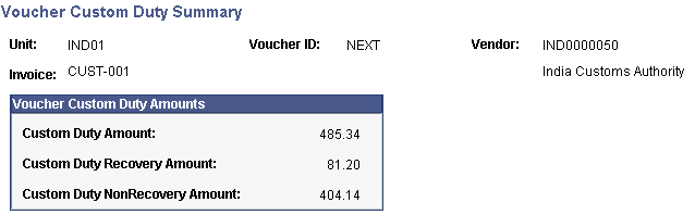

Use the Voucher Custom Duty Summary page (VCHR_CSD_SEC) to display the custom duty amounts.
Navigation:
Click the Custom Duty Summary icon on the Invoice Information page.
This example illustrates the fields and controls on the Voucher Custom Duty Summary page.
You can view the customs duty recovery and nonrecovery amounts at the voucher level.
