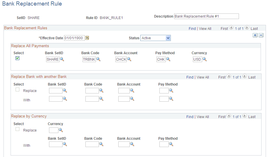

Use the Bank Replacement Rule page (BANK_RPL_RULE_DEFN) to define bank replacement rules.
Navigation:
This example illustrates the fields and controls on the Bank Replacement Rule page (1 of 2). You can find definitions for the fields and controls later on this page.
This example illustrates the fields and controls on the Bank Replacement Rule page (2 of 2). You can find definitions for the fields and controls later on this page.
Use the Select check box to select the bank replacement options that you want to include in the bank replacement rule.
Replace All Payments
Field or Control |
Description |
Bank SetID, Bank Code, and Bank Account |
Enter the identifying information for the bank account from which you want to pay all payments in the pay cycle. This bank account will replace all original bank accounts for the payments selected to run in the pay cycle. |
Pay Method |
(Optional) Select a replacement payment method. Available payment methods include:
This payment method will replace the original payment method on all payments selected for the pay cycle, as long as the original payment method is System Check, EFT, ACH, or Giro-EFT. Payments with any other original payment method specified will still be paid in that original payment method. If you do not specify a payment method, the payments will be made using the payment method specified on the voucher. Note: If the payment will be made using the original payment method, and that payment method is not available for the replacement bank, the system will generate a bank replacement exception and the payment will be dropped from the pay cycle. See Bank / Method Page. |
Currency |
(Optional) Specify a replacement currency. This currency will replace the original currencies specified on all payments selected for the pay cycle. The currency conversion uses the payment date to determine the exchange rate. If you do not specify a currency, the payments will be made in the currency specified on the voucher. Note: If you do not specify a replacement currency and the currency on the voucher is not valid for the replacement bank, the system will generate a bank replacement exception and the payment will be dropped from the pay cycle. |
Note: You cannot select any other replacement options when you select Replace All Payments.
