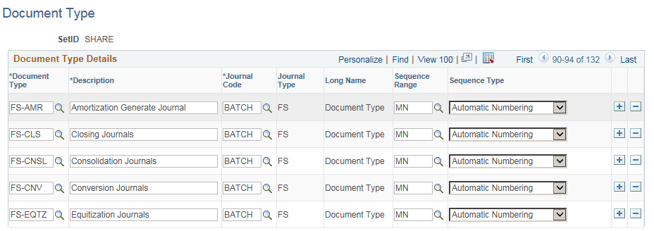

Use the Document Type page (DOC_TYPE) to use this page to define your Payables document types.
Navigation:
This example illustrates the fields and controls on the Document Type page
Once you set up your system for document sequencing, you can use this page to define your payables document types.
