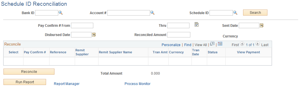

Use the Schedule ID Reconciliation page (BNK_RCN_MAN_TRE) to reconcile a series of federal schedule ID payments.
Run the Account Register report (FSX4004). Use the report to view a list of reconciled or unreconciled Federal Schedule ID payments.

This example illustrates the fields and controls on the Schedule ID Reconciliation page. You can find definitions for the fields and controls later on this page.
Field or Control |
Description |
Pay Confirm # From and Thru |
Enter a range of payment confirmation numbers that are obtained from GOALS - RFCAL. |
Click the Assign Confirmation Number icon to assign a range of schedule ID treasury payment numbers to display unreconciled data. |
Sent Date |
Enter the date on which you sent the payment to the TDO. |
Disbursed Date |
Enter the date on which the TDO disbursed the schedule ID payments. |
Reconciled Amount |
Enter the sum of the payments' amounts that you have assigned in the Pay Confirm # From and Thru fields. |
Reconcile |
Click to reconcile the unreconciled data with the information you enter. This function also performs various audits and displays error messages as appropriate. If the reconciled amount differs from the sum of the payments' amounts (payments assigned a confirmation number), an error message displays. When you click reconcile, the system:
