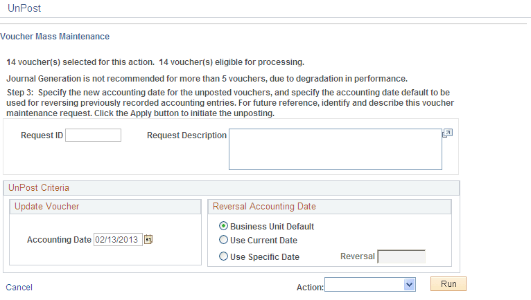

Enter the unposting accounting date, reversal accounting date, and request ID and run the Voucher Mass Maintenance process to unpost the selected vouchers. |

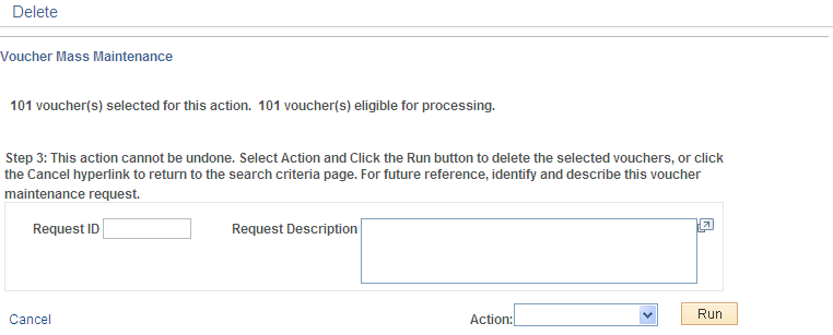

VCHR_MMT_DLTE_SEC1 |
Enter the request ID and run the Voucher Mass Maintenance process to delete the selected vouchers. |

Voucher Mass Maintenance Processing of Voucher Unposting
The Voucher Mass Maintenance process calls the Voucher UnPost Application Engine process (APVCHRUNPOST) to perform the following processing:
Updates voucher status to unposted and updates the accounting date.
Posts reversal entries (with the reversal accounting date selected on the Voucher Mass Maintenance - UnPost page) to the voucher accounting tables.
Updates the ENTRY_STATUS from D or Defaulted to M or Modified.
Updates document sequencing numbers (only if document sequencing is enabled).
Updates Entry Event codes (only if Entry Event processing is enabled).
Note: For performance reasons, it is not recommended to run the Journal Generator process when you are unposting more than five vouchers.
Voucher Mass Maintenance Processing of Voucher Deletion
The Voucher Mass Maintenance process calls the Voucher Delete Application Engine process (APVCHRDELETE) to perform the following processing:
Deletes vouchers from the voucher tables.
The voucher row remains in the voucher tables, but the voucher ID is marked as unavailable. This is irreversible.
Deletes corresponding match exceptions and match details records.
Deletes corresponding duplicate invoice records.
Deletes corresponding doc sequencing records (only if document sequencing is enabled).
Resets the budget checking status of the voucher to Not Checked (only if Commitment Control is enabled).
The voucher is backed out of the budget ledger upon the next run of the Budget Processor.

The UnPost button accesses the Voucher Mass Maintenance - UnPost page.
The Delete button accesses the Voucher Mass Maintenance - Delete page.

Use the Voucher Mass Maintenance - UnPost page (VCHR_MMT_UNPS_SEC1) to enter the unposting accounting date, reversal accounting date, and request ID and run the Voucher Mass Maintenance process to unpost the selected vouchers.
Navigation:
Select vouchers on the Voucher Mass Maintenance page and click the UnPost button.
This example illustrates the fields and controls on the Voucher Mass Maintenance - UnPost page.
Note: If you did not use the appropriate filter criteria on the Voucher Mass Maintenance search page, some of the vouchers you selected may be ineligible for unposting. The page informs you of the number of vouchers you selected and the number of these which are eligible for unposting.
To unpost the eligible vouchers:
(Optional) Identify and describe the unposting request.
Select a new accounting date for the unposted vouchers in the Update Voucher group box.
The system validates that the date occurs in an open accounting period.
Select the accounting date for the reversal accounting entries in the Reversal Accounting Date group box.
This group box appears only if:
One of the vouchers you are unposting has had its accounting entries journal-generated to the general ledger, loaded to asset management, distributed to the Project Costing tables, or distributed to the VAT subsystem.
One of the vouchers is enabled for document sequencing.
If there are any vouchers that are ineligible for the reversal accounting date option that you select, the system will apply the original voucher accounting date to the reversal entries.
If you select either the Use Current Date or Use Specific Date option, the system validates that the date occurs in an open accounting period.
The business unit default accounting date is set up on the Payables Options - Payables Options page.
Select to run one of the following on-demand processes.
Select 1. Mass Maintenance, which performs the Voucher Mass Maintenance process to update the voucher tables and unpost the vouchers.
Select 2. Journal Generator, which performs the Voucher Mass Maintenance process tasks, and also run a process that creates PeopleSoft General Ledger journal entries.
Note: For performance reasons, it is not recommended to run 2. Journal Generator when you are processing more than five vouchers.
After the process completes, a message appears informing you that it was successful.
Use the Voucher Mass Maintenance - Delete page (VCHR_MMT_DLTE_SEC1) to enter the request ID and run the Voucher Mass Maintenance process to delete the selected vouchers.
Navigation:
Select vouchers on the Voucher Mass Maintenance page and click the Delete button.
This example illustrates the fields and controls on the Voucher Mass Maintenance - Delete page.
Note: If you did not use the appropriate filter criteria on the Voucher Mass Maintenance search page, some of the vouchers you selected may be ineligible for deletion. The page informs you of the number of vouchers you selected and the number of these which are eligible for deletion.
To delete the eligible vouchers:
(Optional) Identify and describe the deletion request.
This is required if any of the vouchers on your list are enabled for document sequencing.
Select 1. Mass Maintenance, which performs the Voucher Mass Maintenance process to update the voucher tables and delete the vouchers.
Note: Typically, you cannot delete a voucher if there have been accounting entries generated. However, if only Period End Accrual entries have been generated for the voucher, the voucher will still be eligible for deletion. This will not impact the reversal entry generated by the Period End Accruals. In this case, you should consult with your General Ledger Accounting product members to determine if a manual Journal Entry is desired to reflect the accounting of the voucher being deleted and its effect on the previously generated Period End Accrual.
Warning! Once you click this button, the vouchers will be deleted immediately from the system.
