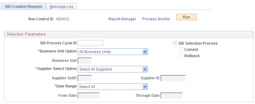

Use the SBI Creation Request page (SBI_CREATE_REQUEST) to specify the SBI selection parameters.
Navigation:
This example illustrates the fields and controls on the SBI Creation Request page. You can find definitions for the fields and controls later on this page.
Note: The ERS vouchers must be posted and matched before you can run the SBI process.
Field or Control |
Description |
Run Control ID |
When you add a new run control ID, the SBI process is set to run in Selection mode and all run mode-related fields are unavailable for entry. The SBI Selection Process check box is selected, but both this check box, and the Commit and Rollback check boxes are unavailable for entry until you have run the SBI process in Selection mode. The mode in which the PeopleSoft Application Engine process runs is always controlled through PeopleCode. |
SBI Selection Process |
Select to run the SBI process in Selection mode rather than Commit or Rollback mode. When you enter a new run control ID, the system automatically selects the Selection process for you, and you cannot change the field. |
Commit |
Select to run the SBI process in Commit mode rather than Selection or Rollback mode. You can only select this option after you have run the SBI process in Selection mode. After you run the SBI process in Selection mode, the system automatically changes to the Commit mode for you. |
Rollback |
Select to run the SBI process in Rollback mode rather than Selection or Commit mode. You can only select this option after you have run the SBI process in Selection mode. |
Date Range |
Enter to restrict the vouchers selected for the SBI process using the invoice date. Values are: Select All: Selects all the vouchers regardless of date range. Specify: Enter a date range in the From Date and Through Date fields. |
During the SBI Selection process, the system:
Identifies candidate vouchers.
SBI_Flag = Y
SBI_In_Process_Flag = N
Voucher_Type = E
Post_Status_AP = P
SBI_Num = 0 or blank
SBI_Doc_Opt = G/I/P
Invoice_Date between From_Date and Through_Date from request page and also satisfying business unit and supplier selection options.
MATCH_STATUS_VCHR = M
Updates vouchers as SBI is in process.
Processes vouchers with SBI_Doc_Opt as I or P.
Processes vouchers with SBI_Doc_Opt = G.
Group them using criteria mentioned in Voucher Creation/Process section.
Assigns sequentially generated dummy SBI numbers starting with 1 for SBIs under each supplier or location regardless of SBI_Doc_Opt.
Creates data in VCHR_SBI_P and VCHR_SBI_DATA_P.
Sets the initial approval status for these SBIs based on supplier or location approval status.
Marks SBI_CREATE_RQST to indicate selection process is complete.
