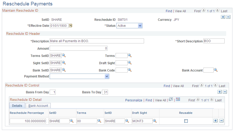

Use the Reschedule Payments page (SMT_SPLIT_CDTN) to add, update, and correct reschedule conditions that define agreements with your suppliers.
Navigation:
This example illustrates the fields and controls on the Reschedule Payments page. You can find definitions for the fields and controls later on this page.

Using the example in the screen shot, the following conditions apply:
When the total amount of vouchers in a certain period of time is less than or equal to 10,000,000 JPY, pay the full amount with EFT at the end of month.
When the total amount of vouchers in a certain period of time is over 10,000,000 JPY and the basis date is between the 1st and the 15th, pay for 60 percent of the total in EFT at the end of the month and pay for 40 percent of the total in customer initiated draft with draft sight three months at the end of the month.
Notice that in this screen shot, the Reusable check box is selected for the 40 percent line. That means that the system evaluates scheduled payments every time that you run the Reschedule Payments process.
When the total amount of vouchers in a certain period of time is over 10,000,000 JPY and the basis date is between the 16th and the 31st, pay for 50 percent of the total with a check on the 10th of the next month and pay for 50 percent of the total in customer initiated draft with draft sight 3 months on the 10th of the next month.
