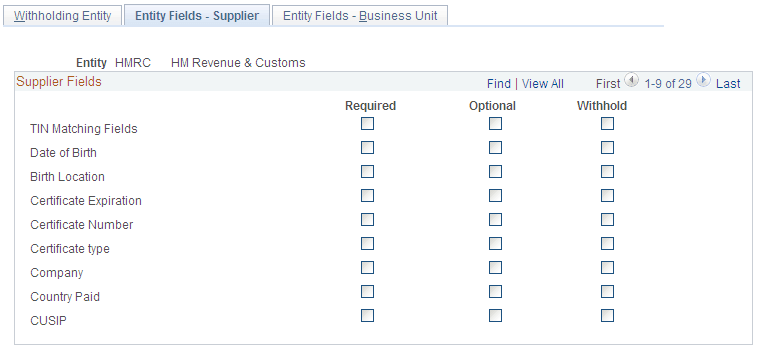

WTHD_ENTITY_FIELDS |
Indicate which information the tax authority (entity) requires for your suppliers. |
BU_WTHD_ENT_FLDS |
Indicate which information the tax authority (entity) wants to know about your business units. |

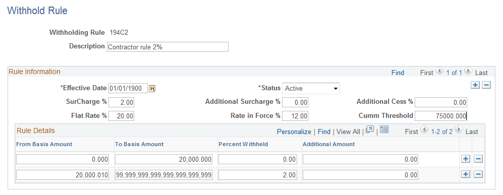

Use the Withhold Rule page (WTHD_RULE) to establish rules that determine the actions to be taken during withholding.
For example, you can create rules to define the amount of withholding and to determine different percentages based on the size of the transaction amount. You can also create tiered-based withholding on this page.
Navigation:
This example illustrates the fields and controls on the Withhold Rule page. You can find definitions for the fields and controls later on this page.
Field or Control |
Description |
(IND) SurCharge % (surcharge percent) |
Enter any surcharge percentage as applicable. Surcharges are for Indian withholding and represent a percentage of the calculated tax amount which is added to the calculated tax amount for withholding. Note: According to India Income Tax Rules, in case the supplier’s PAN Number is not available, then the transaction is subject to Withholding at a flat rate of 20%. In this case Surcharge and Cess do not apply. |
(IND) Additional SurCharge % (additional surcharge percent) |
Enter an additional surcharge percent that is to be used for calculating the Education Cess tax levy, if required. |
(IND)Additional Cess % |
Enter any additional Cess charge to be used for calculating the Higher Education Cess tax levy, if required. |
(IND) Flat Rate % |
Enter a flat rate percentage value. This percentage value is applied in calculating TDS Withholding only if there is no PAN number associated with the supplier. If a PAN number exists for the supplier, this value is not considered for TDS Withholding Calculation. Note: A flat rate of 20 percent is charged if there is no PAN number for the supplier. |
(IND) Rate in Force % |
Enter a rate in force percent value if there is a change in rate within the fiscal year. |
(IND) Cumm Threshold |
Enter a cumulative threshold amount. This amount is used as a reference to accumulate the withholding amounts. Withholding begins calculation only if the total voucher amounts exceed the value entered (75000, in this example). Also, in order to calculate Withholding, the individual voucher amounts should be greater than the amount entered in the row corresponding to the To Basis Amount, requiring that the Percent Withheld value is greater than zero. |
You can use the Rule Details group box to define the withholding percentage within specific amount ranges, enabling you to specify tiered withholding.
Field or Control |
Description |
From Basis Amount |
Enter the lower amount of a range for which you want to define a percentage to be withheld. |
To Basis Amount |
Enter the upper amount of a range for which you want to define a percentage to be withheld. |
Percent Withheld |
Enter the percentage to be withheld for the range you defined. |
Additional Amount |
Enter any additional amount to be added to the withholding calculation, as appropriate. This field is used for tier-based withholding. |

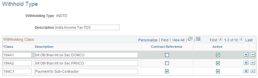

Use the Withhold Type page (WTHD_TYPE) to define withholding at the highest level.
For example, in the U.S. 1099 is a withholding type. For each withholding type, you can define subdivisions or classes, such as rent or royalties.
Navigation:
This example illustrates the fields and controls on the Withhold Type page. You can find definitions for the fields and controls later on this page.
Use the Withholding Class grid to specify the withholding classes.
Field or Control |
Description |
Class and Description |
Specify any classes that belong to this withholding type, and enter a description for each class that you add. |
(IND) Contract Reference |
Select to require a contract reference when creating a voucher with this withholding class. This feature is for Indian withholding only. |
Active |
Select to indicate withholding class is active. The withholding class is available immediately for you to use to define your withholding entity options. |

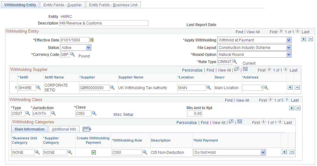

Use the Withholding Entity page (WTHD_ENTITY) to define your withholding entities (tax authorities).
Enter the withholding entity information including supplier, class, and category information for the entity. The withholding entity component ties the withholding information together.
Navigation:
This example illustrates the fields and controls on the Withholding Entity page. You can find definitions for the fields and controls later on this page.
Note: You must define the supplier information for the withholding supplier or suppliers in the Supplier Information component before you can complete the Withholding Entity page.
Withholding Entity
Field or Control |
Description |
Apply Withholding |
Use this field to determine whether the withholding calculation for any withholding belonging to this entity should occur at Payment or at Vchr Post (voucher post). If you select Payment as the withholding calculation setting, this setting can be overridden by users with the appropriate authority on the voucher Withholding Information page provided the voucher has not been posted and a payment has not been made. Note: You set up the security for overriding withholding calculation using the User Preferences component. |
Currency Code and Rate Type |
Specify the reporting currency code and exchange rate type for the entity. |
File Layout |
Select the appropriate reporting file layout. |
Round Option |
Select the appropriate rounding option: Down: Round all decimals down to the next whole number. Natural: Round normally. If the calculated withholding amount is less than five, round down; if it is five or above, round up. (IND) NRR (Nearest Rupee Rounding): Select to round to the nearest Rupee. If an amount contains a part of a rupee consisting of paise then, if such part is fifty paise or more, it will be increased to one rupee and if such part is less than fifty paise, it will be ignored. TDS: Selecting this value rounds decimal amounts to the appropriate zero decimal, regardless of the installed currency configuration. Up: Round all decimals up to the next whole number. |
Withholding Supplier
Use this group box to define all applicable withholding remit suppliers for this entity. You can associate one or multiple SetID and supplier combinations with the withholding entity.
Field or Control |
Description |
SetID, Supplier, and Location |
Select the SetID, supplier, and location associated with the withholding entity. The Withhold Calculation process retrieves the withholding supplier ID for the corresponding SetID based on the TableSet control value for the PeopleSoft Payables business unit of the supplier used during voucher entry. For example, for a PeopleSoft Payables business unit that uses SHARE as the SetID for suppliers, the Withhold Calculation process selects the withholding supplier ID defined for the SHARE SetID on the Withholding Entity page. |
Withholding Class
Use this group box to specify all the possible combinations of withholding types, jurisdictions, and classes for this entity.
Note: For the sake of brevity, sometimes the combination of withholding entity, type, class, and jurisdiction are referred as a withholding class combination.
Field or Control |
Description |
Misc. Setup (miscellaneous setup) |
Click to access the Withholding Options page, where you can select options that determine what constitutes the basis for your withholding. |
Min Amt to Rpt (minimum amount to report) |
Enter a minimum withheld amount above which you create reporting information for a supplier. |
Note: When you add a new withholding class for an entity, the system automatically adds the class and account ChartField on the Withholding ChartFields page. The system displays a warning stating that you should verify the information on the procurement control (Procurement Control - Withholding and Withholding ChartFields pages).
When you delete a withholding class for an entity on the Withholding Entity page, the system displays a warning message stating that you must delete the withholding class from the procurement control (Withholding ChartFields page) as well.
Withholding Categories
Use this group box to tie any business unit and supplier categories to your withholding rules. Different combinations of business unit and supplier categories may require different withholding rules.
Entities may categorize your business units differently. For example, in Argentina, one business unit may be considered centralized while another is considered decentralized. Different withholding parameters may be offered for each based on the type of business unit. Likewise, your suppliers may also be categorized differently, depending on whether the suppliers are registered or non-registered. Again, their withholding parameters may vary depending on the type of supplier with which you conduct transactions. The fields in the Withholding Categories group box enable you to capture all of the different possible relationships you may have with your entities and your suppliers, and the resultant withholding percentages, or rules which apply when you transact with them.
Main Information Tab
Field or Control |
Description |
Business Unit Category |
Select the business unit category for this entity, as applicable. |
Supplier Category |
Select the supplier category for this entity, as applicable. |
Create Withholding Payment |
Select if you want to create separate payments for the withholding. Otherwise, withholding is not calculated, although basis amounts are reported. Note: Creating a zero percent withholding rule accomplishes the same result. |
Withholding Rule |
Select the withholding rule to which these categories apply. |
Hold Payment |

Use the Entity Fields - Supplier page (WTHD_ENTITY_FIELDS) to indicate which information the tax authority (entity) requires for your suppliers.
Navigation:
This example illustrates the fields and controls on the Entity Fields - Supplier page.
For each of the supplier fields listed you can select whether it is Required or Optional when users enter supplier information.
The Withhold field is delivered as a non functional field. You may want to configure it to your particular withholding requirements.
