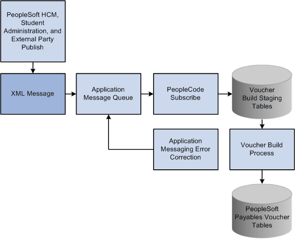

Voucher EIP application messages (including voucher data from PeopleSoft Payroll, Student Administration, and any other sources connected through the Voucher EIP).

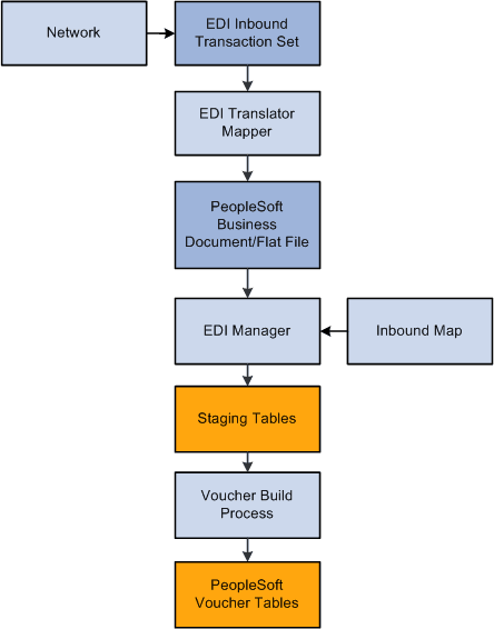

The Voucher Build process provides support for data that is connected through EDI.
This flowchart illustrates how the EDI Manager integrates with the Voucher Build process.
Typically, you use a private value-added network (VAN) to exchange EDI transactions. However, you can also use the internet, a dedicated link, or a sole-source provider.
EDI Transaction Processing
To process EDI transactions:
Translate the EDI file.
The translator converts the EDI transactions into a PeopleSoft business document format. A PeopleSoft business document is a layout that describes the fields—including name, type, length, format, short name, and long name—that make up the EDI file.
To translate a data file into a PeopleSoft business document, use a translation tool that prepares, parses, and maps the flat file into the PeopleSoft business document format. You can develop this tool yourself, or you can use third-party tools that are readily available.
Use EDI Manager to load the business document.
EDI Manager uses a supplied EDI agent Structured Query Report (SQR) to import the electronic data flat file, translate the data using the PeopleSoft business document layout, and stage the data in the Voucher Staging tables in the PeopleSoft database.
Use the Schedule Inbound EC Agent - Run Control Parameters page in EDI Manager to load the flat file with the invoice data into the staging tables.
Confirm that the data loaded into the staging tables successfully.
Use the Business Document Summary page in EDI Manager to confirm that the status is Loaded.
Run the Voucher Build process to create voucher records and load them in the Voucher tables.
Use the outbound AP_VCHR_MESSAGE_OUT EIP that was initiated in the Voucher Build process to send verification messages to the sender.

PeopleSoft Payroll, Student Administration, and other external systems can process supplier payments, such as payroll deductions, through PeopleSoft Payables using the inbound Voucher EIP. The Voucher EIP uses Application Messaging and the VOUCHER_BUILD message definition to populate the voucher staging tables with the necessary information for building voucher record sets.

This flowchart illustrates the VOUCHER_BUILD message subscription process.
