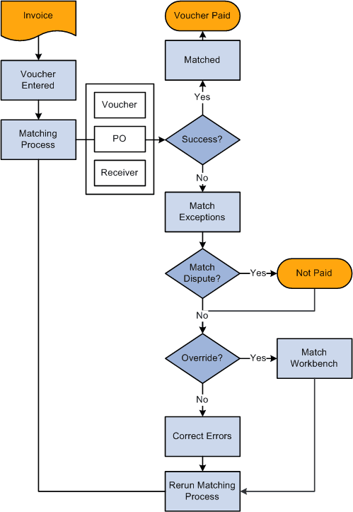

This flowchart provides an example of the three-way matching process, illustrating how the Matching process compares the entered voucher to the purchase order and receiving documents.
After you set up the Matching process and create vouchers to be matched:
Specify the matching run control options and run the process on the Match Request page, from the Action field on the Invoice Information page in the Voucher component (VCHR_EXPRESS), or from the Match Workbench.
If vouchers match successfully, the system sets the status of these vouchers to Matched and the voucher is available for payment.
If vouchers do not pass the Matching process, the system flags them as exceptions.
The system logs each match rule exception for the voucher in a voucher match exception log table that you can view using the Match Workbench. You can access the Match Workbench from the Match Request page, by clicking the Exceptions link on the Voucher Summary page in the Voucher component, or through general navigation.
View the exceptions on the Match Exception Workbench Details page, where you can set the vouchers that have match exceptions to Credit Note, Match Dispute, or Override.
You can also select a match rule action of Debit Memo if you specified it as an action on the Match Rule Type page and associated it to the match rule. The Matching process creates a debit memo adjustment voucher to resolve the matching exception.
Note: Users need to have authority to override match exceptions to select match actions of Credit Note, Match Dispute, or Override. Define authority to override match exceptions on the User Preference - Procurement: Payables Online Vouchering page.
Vouchers with a match status of Match Dispute are not paid and remain in an unpayable state until you delete or correct them.
The next time that the Matching process runs, the system bypasses the individual match rules that you override.
Overridden vouchers are available for payment and are paid the next time the pay cycle is run.
Note: Organizations typically correct a problem instead of overriding it. In general, it is best to rectify and reprocess incorrect associations and supplier differences rather than override them.
Note: You can pay unmatched vouchers at the user ID level if you select the Pay Unmatch Voucher option on the User Preference - Procurement: Payables Online Vouchering page.
PeopleSoft Workflow notifies the appropriate user about the match exception, based on the route that you specify for the exception on the Match Rule Type page or the Match Rules - Workflow page.
Correct the errors and rerun the Matching process.

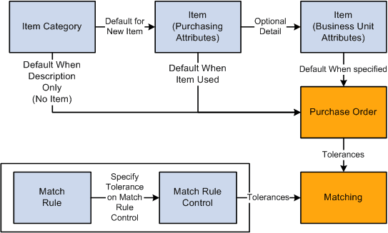

You can also change the price and tolerances (upper and lower limits) for matching in the Price Tol (unit price tolerance), Ext Tol (total amount tolerance), and Pct (percentage) fields. The values for these fields appear by default from the item definition.
You can define value and percent tolerances to override exceptions generated by the match rules. The Matching process uses match tolerances when comparing the prices and amounts. If a match exception exists, and the voucher is within the tolerances established in these components, the Matching process automatically overrides the exception. There are two ways you define match tolerances, they are:
On the match rule.
On the purchase order.
Define the value or percent match tolerances for each match rule on the Match Rule Control page. In order to define match tolerances, you must first indicate on the Match Rules - Rule Definition page to use match tolerances at the match rule control level.
Define value or percent match tolerances at the purchase order level on the Item Categories component (ITEM_CATEGORIES) and the Purchasing Attributes component (PURCH_ITEM_ATTR). These match tolerances can be overridden on the Maintain Purchase Orders component.
PeopleSoft delivers match rule controls that apply matching tolerances either at the PO level or at the match rules level. You should apply tolerances at the PO level or at the match rule level, but not both. To modify or add match rule controls with tolerances, you must understand the Matching process and how tolerances work.
The Standard Match Rules Using PO Tolerances match rule control applies matching tolerances at the PO level.
The Standard Match Rules Using Rules Tolerances match rule control applies matching tolerances at the match rules level.
The Standard match rule control applies matching tolerances at the PO level.
The Debit Memo match rule control applies matching tolerances at the match rules level.
The Basic match rule control applies matching tolerances at the PO level.
