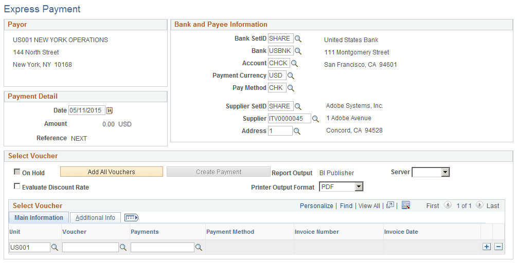

Use the Express Payment page (PYMNT_EXPRESS) to create a payment for one or multiple vouchers for one specific supplier.
Navigation:
Accounts Payable > Payments > Express Payments > Create Express Payment > Express Payment
This example illustrates the fields and controls on the Express Payment page. You can find definitions for the fields and controls later on this page.
Note: Multiple views of this page are available by clicking the tabs in the scroll area.
Note: Only one payment is created for the supplier, unless the Separate Payment option or the Do Not Mix Units options are selected. In those cases, more than one payment can be created to pay the supplier.
Payor
This group box displays the payor information. If you have multiple payments being paid for the same bank, it is possible that the payor could be different than what appears on the page.
Bank and Payee Information
The bank and payee information appears by default from the schedule payment selected on the Voucher - Payments page.

Date
Enter the date that prints on the check.
Amount
Displays the amount of the payment, based upon the vouchers that are selected in the Select Voucher group box.
Reference
Displays the number of the check. NEXT indicates that the system generates the number, incrementing the reference number based on the last number that it used for a check in the specified bank account.
Once you select a bank SetID and a supplier SetID, the system displays the name and address of the bank and supplier information in this group box.

Bank SetID
Enter the bank SetID, bank, and bank account from which the payment is drawn.
Payment Currency
Enter the payment currency.
Pay Method
Enter the pay method.
Supplier SetID
Enter the SetID, supplier ID, and address of the supplier you are paying.
Select Vouchers
Field or Control
Description
On Hold
Specifies whether the payment scheduled is on hold. The holding option can be set manually or by a scheduled process. For example, the withholding process places those vouchers with withholding exceptions on hold.
Evaluate Discount Rate
Select for the system to compare where you receive the most benefit, such as paying a discounted voucher early and taking the discount or waiting for the due date and earning the interest income during that time.
Printer Output Format
Select the printer output format for printing checks from the options:
  • PCL
  • PDF
  • PS
Note: The printer output format is PDF by default. You may select the PCL or the PS option and recreate the check with new reference number or reprint using same reference number.
Add All Vouchers
Click to automatically enter all outstanding payments for the supplier to this payment.
Create Payment
Click to generate a pay cycle with the name XPC001 through XPC999. The system transfers you to the Express Payment Manager page to complete your check processing.
Note: If financial sanctions validation is enabled, the system validates the supplier against financial sanctions lists (for example, the SDN list) upon clicking the Create Payment button. The system does not allow you to create a payment for a supplier with a financial sanctions status of Review or Blocked. However, if financial sanctions validation is enabled at the bank level and you no longer validate for a particular supplier's bank, the system may allow you to create an express payment for a supplier with a financial sanctions status of Review.
See Understanding Financial Sanctions Validation.
