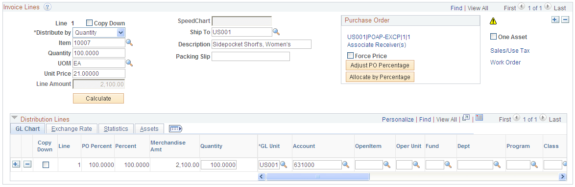

You can also view voucher errors directly from the Invoice Information page and the Payments page.
This example illustrates the fields and controls on the Invoice Lines group box on the Invoice Information page, showing the Go to Review Errors icon. You can find definitions for the fields and controls later on this page.
Field or Control |
Description |
Click the Go to Review Errors icon to view a description of a voucher error:
