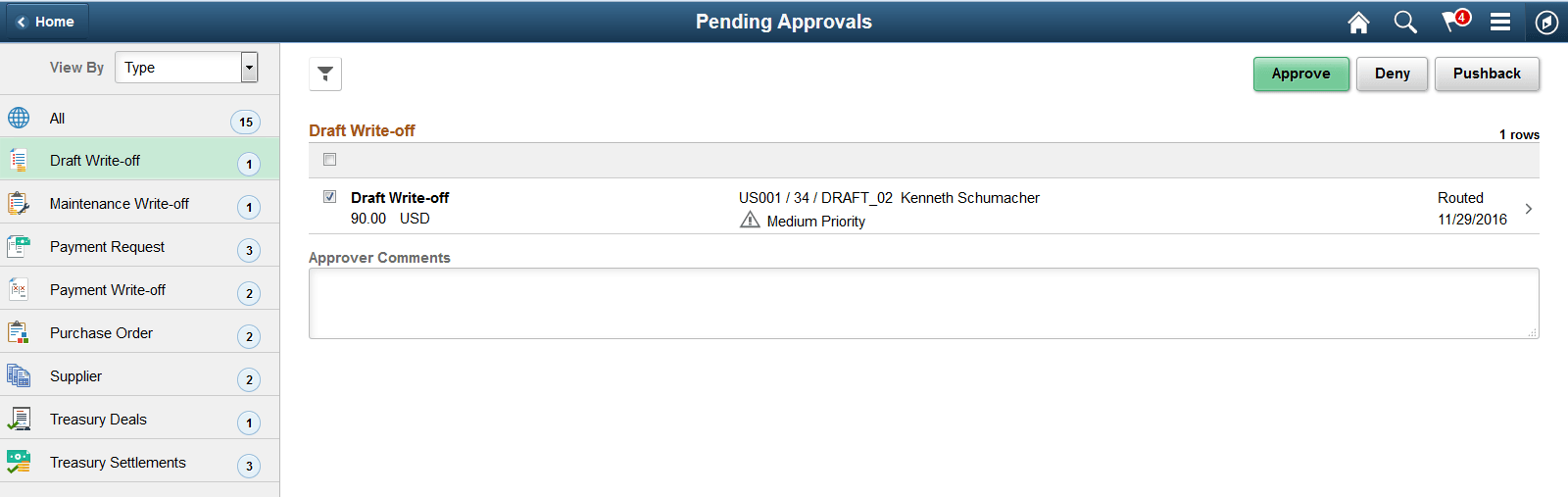

Use the Draft Write-off – Pending Approvals page (EOAWMA_MAIN_FL) to view a list of all transactions that apply to the selected transaction category and access the respective transactions that are pending your approval.
Navigation:
Select Draft Write-off in the approval transaction types panel.
This example illustrates the fields and controls on the Draft Write-off – Pending Approvals list page as displayed on a desktop (LFF).
This example illustrates the fields and controls on the Pending Approvals - View By Transaction Type panel as displayed on a phone (SFF). Select Draft Write-off in the transaction type list to open the list of draft write-off pending approvals.
This example illustrates the fields and controls on the Draft Write-off – Pending Approvals list page as displayed on a phone (SFF).
Field or Control |
Description |
Select the filter button to open the Filters page. Use the filter to refine the results displayed in the list of pending approvals for draft write-offs. |
(SFF) Select the Master button on the phone to hide or unhide the panel that shows available transaction types with pending approvals. Select Draft Write-off transaction type to view the pending approvals for draft write-offs. |
Select one or more check boxes to take action on one or more transactions. Enter comments in the Comment field. Then select one of the following approval action buttons:
Field or Control |
Description |
Approve button |
Select to approve the selected transaction or transactions. The system prompts you to provide comments and submit the approval. This action routes the approval to the next approver in the chain. |
Deny button |
Select to deny the selected transaction or transactions. When you deny a transaction, that status changes to Denied and the transaction is removed from the approval queue. |
Pushback button |
Select to send the request back to the previous approver. This option is only available for second or subsequent approvers in a multiple-approver workflow path. |
Upon selecting an action, you have the option to select Submit to continue the action or Cancel to back out of the action. When you submit the action, the system generates a message that the action is successful.

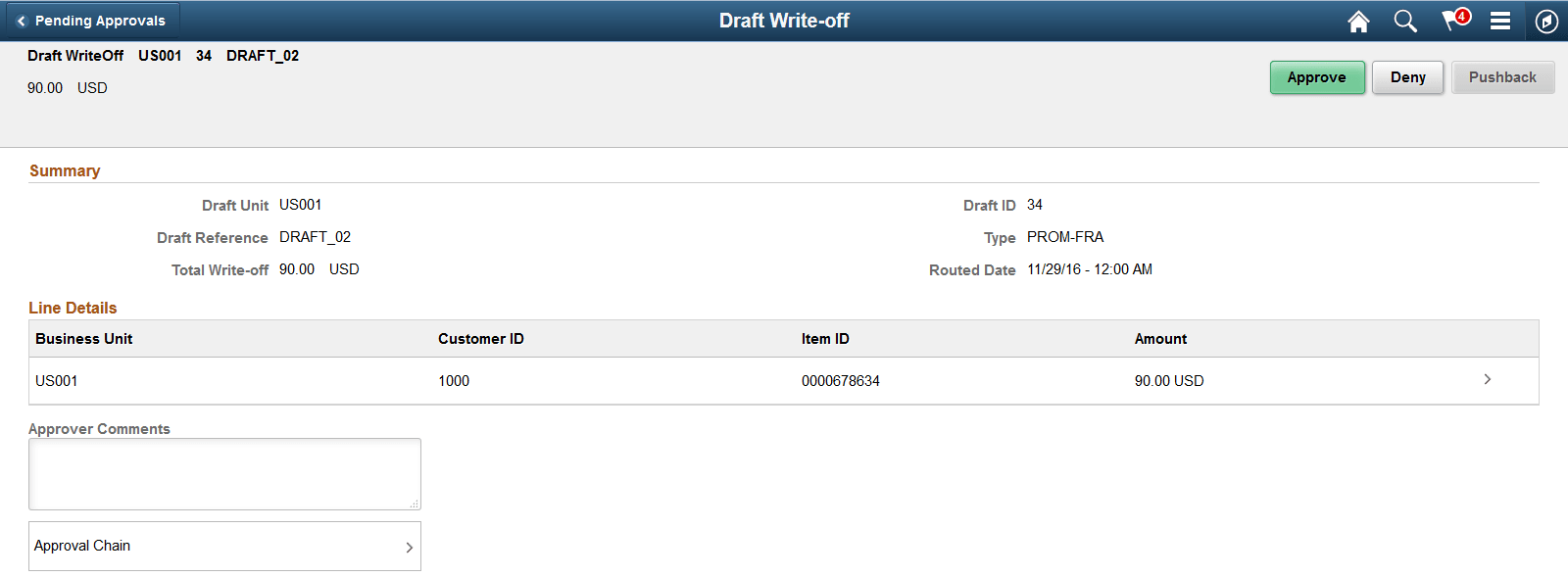

Use the Draft Write-Off – Approval Header Detail page (EOAWMA_TXNHDTL_FL) to review the summary for a single write-off, and approve, deny, or push back the write-off, depending on role criteria and number of reviewers.
Access line item details for a specific line and attachments, if any.
Navigation:
Select a draft write-off transaction in the Pending Approvals list.

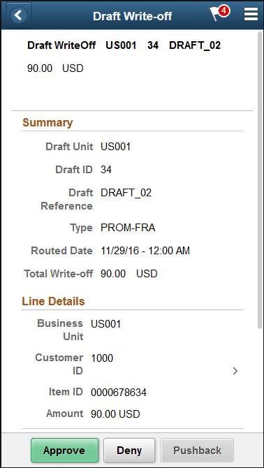

This example illustrates the fields and controls on the Draft Write-off – Approval Header Detail page as displayed on a desktop (LFF).
This example illustrates the fields and controls on the Draft Write-off - Approval Header Detail page as displayed on a phone (SFF). On a phone, you must scroll down to view the attachments, comments, and approval chain fields.
Field or Control |
Description |
Summary |
View write-off item details. |
Line Details |
View line information and select the right arrow to access the line details. |
When viewing write-off header approval detail on a phone, you must scroll down to view the approver comments and approval chain.
