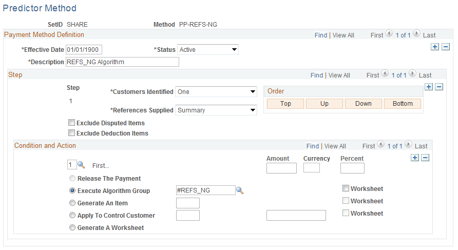

Use the Predictor Method page (PP_METHODS_TABLE) to define a payment predictor method.
Navigation:
This example illustrates the fields and controls on the Predictor Method page. You can find definitions for the fields and controls later on this page.
Step
Each step consists of one or more payment conditions; each condition has an action. The step number determines the order in which the step is processed in the method.
Click the Order buttons to change the order of the steps.
Field or Control |
Description |
Customers Identified |
Select if customers must be identified for this step. Values are: None, One, More Than One, and Doesn't Matter. |
References Supplied |
Select the type of reference information that the payment must have for this step. Values are: Summary: Use summary references (references such as an invoice number without amounts). Detail: Use detail references (references such as an item ID with an amount). No: No reference identification. Doesn't Matter: Process the step with or without reference information. In some cases, you do not care about customer information or payment references. For example, if you receive payment references, you can designate that customer information Doesn't Matter or vice versa. You might even define a step using Doesn't Matter in both cases: no matter how many customers are involved and regardless of payment reference information, take the specified action. |
Exclude Disputed Items |
Select if you do not want to apply payments to items in dispute. |
Exclude Deduction Items |
Select if you do not want to apply payments to deductions. |
Condition and Action
A step must have at least one condition. You can assign up to seven conditions to a step and select one of five actions for each condition. The conditions cannot conflict with each other. The number of the condition determines the order in which it will be processed within the step. Values are:
First...
Any Overpayment
Overpayment Exceeds
Overpayment Is Less Than
Any Underpayment
Underpayment Exceeds
Underpayment Is Less Than
Note: If you use Any Overpayment or Any Underpayment, you cannot use the tolerance choices for overpayments or underpayments that exceed or fall short of a certain amount. The reverse is also true. If you use Overpayment Exceeds, Underpayment Exceeds, or Underpayment Is Less Than, you cannot use Any Overpayment or Any Underpayment. The exceptions are the #DTL_TLR and the #DTL_TPM algorithm group. For the #DTL_TLR and #DTL_TPM algorithm groups, you should not select any of the underpayment or overpayment conditions. The conditions for exceptions for this algorithm group are defined using the Predictor Detail Options page.
See Receivable Options - Predictor Detail Options Page.
Field or Control |
Description |
Amount or Percent |
If you select an overpayment or underpayment, enter values in one or both of these fields. For example, you can specify an action when an overpayment is less than 100.00 EUR or less than 12 percent of the payment. If you specify both an amount and a percent, the system processes the overpayment or underpayment as long as one of the tolerance criteria is met. You can specify only one set of tolerance criteria for each condition. Enter the currency for the amount to enable the system to convert amounts properly when determining whether a write-off amount meets the tolerance. |
You must select one of the following actions:
Field or Control |
Description |
Release The Payment |
Select to have Payment Predictor reset the payment for processing in a subsequent step. Normally, if Payment Predictor has applied even part of a payment, it ignores that payment in future steps. You can release the payment several times within a method. Not available for condition 1, First. |
Execute Algorithm Group |
Select to have Payment Predictor run the SQL statements that are predefined as part of the selected algorithm group. A field appears to the right, so you can select the algorithm group. If the method results in successful application, the payment status is Applied, and Payment Predictor creates a group and sets the posting action to Batch Standard. You can look at the group using an inquiry page. Select Worksheet to have Payment Predictor create payment worksheets instead of setting the posting action for the payment to Batch Standard. |
Generate an Item |
Select to have Payment Predictor create a pending item according to the system function that you provide in the field that appears. The payment status is Applied, and the posting action is Batch Standard. Select Worksheet to have Payment Predictor create payment worksheets instead of setting the payment to a Batch Standard posting action. For an underpayment or overpayment condition, when more than one customer is identified in the PS_PP_CUST_TAO table, Payment Predictor will not create an adjustment item. Instead, it will create a payment worksheet and leave the remaining amount on the worksheet. You must manually balance the worksheet. The MAX function in SQL determines the highest ID through an alphanumeric sort sequence that will differ by database platform. Valid system functions differ according to the payment conditions. Condition 1 can use only WS-05. Conditions 2, 3, and 4 can use only WS-04, WS-05, WS-06, and WS-10. Conditions 5, 6, and 7 can use only WS-07, WS-08, and WS-11. |
Apply To Control Customer |
Select to have Payment Predictor place the payment or remaining amount on account for the control customer business unit and customer ID that you provide. (If you omit the business unit, the system uses the deposit business unit by default.) The payment status is Applied, and Payment Predictor creates a group and sets the posting action to Batch Standard. Select Worksheet to have Predictor create payment worksheets instead of setting the posting action for the payment to Batch Standard. This option is useful for placing payments on a control account when no customer is identified. This action is available only for Condition 1, First. |
Generate A Worksheet |
Select to have Payment Predictor create a payment worksheet for online review. The payment status is Worksheet. You can look at the resulting payment worksheet by accessing the Worksheet Selection page. The worksheet has the items that Payment Predictor matched with payments, plus the suggested overpayments and underpayments. You can then use the worksheet to accept the results of Payment Predictor processing as is or to make manual adjustments. When you are done working with the payment worksheet, you can post the payments. |
Note: If you select Apply To Control Customer and Payment Predictor cannot identify any customers, Payment Predictor determines whether the default method associated with the deposit business unit indicates Apply To Control Customer when the customer identification is missing or is set to Doesn't Matter.
