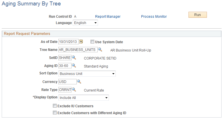

Use the Aging Summary by Tree page (RUN_AR30002) to define the run parameters for the Aging Summary by Tree report (AR30002).
Use the report to see aged open balances for a tree structure in the base currency of the business unit. You can run the report for these trees: AR_CORP_CUST, AR_BUSINESS_UNITS, COLLECTOR, CR_ANALYST, and SALES_PERSON. (SQL)
Navigation:
This example illustrates the fields and controls on the Aging Summary By Tree page.

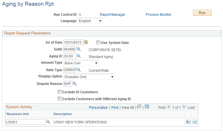

Use the Aging by Reason Rpt page (RUN_AR30007) to define run parameters for the Summary Aged by Reason Code report (AR30007).
Use the report to see aged open balances for deductions, items in collection, or disputed items for all customers in a business unit in either the base currency of the unit or the entry currency. Select the entry currency to show subtotals by currency. (SQL)
Navigation:
This example illustrates the fields and controls on the Aging by Reason Rpt page.
You can run this report for a specific reason or all reasons. Depending on your selection in the Display Option field, the reason that you enter varies:
If you selected Collections Only, select a Collection Code.
If you selected Deductions Only, select a Deduction Reason.
If you selected Disputes Only, select a Dispute Reason.

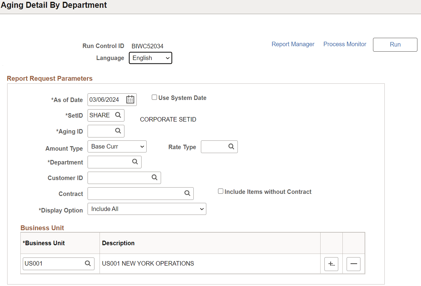

Use the Aging Detail By Department run control page (RUN_AR30009) to define run parameters for the Aging Detail by Department report (AR30009).
Use the report to see the age of open balances for all items in a given department, totaled by contract number and grouped by customer ID and business unit. Select the entry currency to show subtotals by currency. (SQL)
Navigation:
This example illustrates the fields and controls on the Aging Detail By Department page.
Field or Control |
Description |
Aging ID |
Enter an aging ID defined in the system. |
Amount Type |
Select from Base Curr (base currency) or Entry Curr (entry currency). |
Rate Type |
Enter a rate type. |
Department |
Enter a department ID. Enter ALL_DEPTS to run the report for all departments. |
Customer ID |
Enter a customer ID. |
Contract |
Enter a contract ID or a wildcard (%) for all contracts for the selected department and customer. |
Include Items without Contract |
Select the check box to include items without contract on the report. |
Display Option |
Select an option from the drop-down list:
