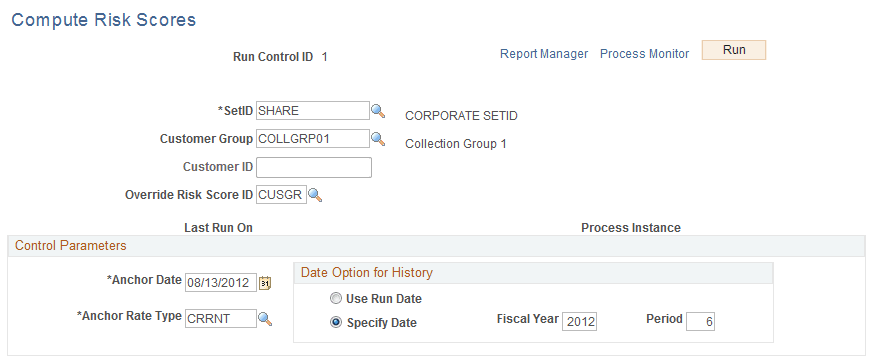

Use the Compute Risk Scores page (RUN_AR_RISK) to run the Request Risk Scoring Application Engine process (AR_RISK).
Navigation:
This example illustrates the fields and controls on the Compute Risk Scores page. You can find definitions for the fields and controls later on this page.
Field or Control |
Description |
Override Risk Score ID |
Select a risk score id if you want to run the risk scoring process for only one risk scoring rule. If you select a value for this field, the risk score process will only process this selected rule and will override the risk score processing hierarchy that runs based on your selection of a SetID value and Customer Group or Customer ID. Leave this field blank if you want to process all rules that apply based on the selection criteria. |
Anchor Date |
Select the date to apply to the currency conversion when processing this risk score. The currency is derived from the risk score rule. This is a required field. |
Anchor Rate Type |
Select the rate type to apply to the currency conversion when processing this risk score. This is a required field. |
Date Option for History |
Select one of these dates to use for retrieving history data:
