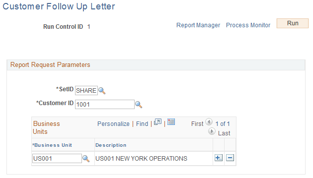

This example illustrates the fields and controls on the Customer Follow Up Letter page. You can find definitions for the fields and controls later on this page.
Field or Control |
Description |
SetID |
If you use only a SetID, the process creates follow-up letters for each correspondence customer in every business unit that references the TableSet. |
Customer ID |
Enter a customer ID to create follow-up letters for the specified customer. If you select a customer who is part of a correspondence group, the system addresses the statement to the correspondence customer but includes only the specified customer's information. Enter a wildcard (%) to process all customers for multiple business units. |
Business Unit |
Enter a business unit to create follow-up letters for all customers in a specific business unit. The system enables you to specify multiple business units. |
