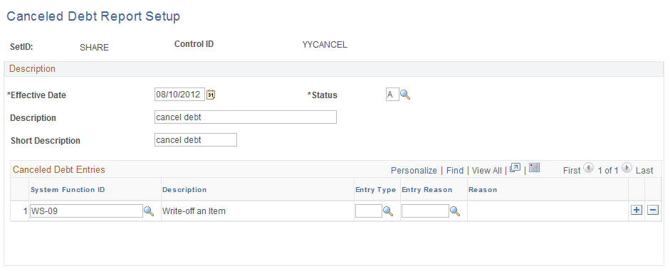

Use the Canceled Debt Report Setup page (AR_CANCEL_DEBT_RP) to define control values to identify the type of system function codes to use for canceled debt reporting.
Navigation:
This example illustrates the fields and controls on the Canceled Debt Report Setup page. You can find definitions for the fields and controls later on this page.
You must enter at least one System Function ID in the Canceled Debt Entries grid. Control values identify which function codes the system will use to report canceled debt. If desired, you can further limit which system function codes to select by entering an Entry Type and Entry Reason.
Only transactions with a Posted status in the Item Activity table are eligible for 1099-C reporting. If only the system function code is selected without a qualifying entry type or reason code, all transactions with the system function code are considered eligible. If a user defines an entry type and entry reason, only transactions with the specified entry type and entry reason are selected; all other entry types and entry reasons for the system function code will be ignored.
Reporting Interest Amounts in Box 3
The amount of canceled debt reported on the 1099-C form includes write-offs of principal owed, which can also include interest, administrative fees, and penalties, as specified in the Canceled Debt Entries on the Canceled Debt Report Setup page.
To report interest amounts in Box 3 of the 1099-C form, you must add a Canceled Debt Entry using system functions FC-01 and/or IT-01 with OC in the Entry Type field to designate Overdue Charges. If desired, you can include an Entry Reason value to further filter which types of overdue amount transactions are reported in Box 3 of the 1099-C form.
Note: On the Canceled Debt Report Setup page, entry type OC is reserved for reporting interest amounts in Box 3 of the 1099C form. Entry type OC will not be used for reporting amounts in Box 2.

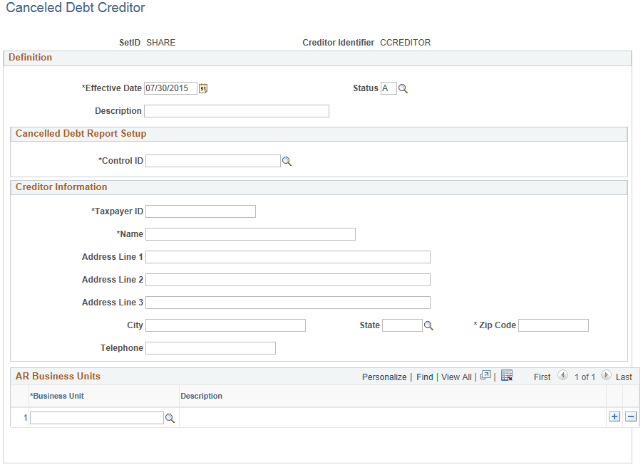

Use the Canceled Debt Creditor page (AR_CANCEL_DEBT_CR) to enter creditor taxpayer ID and address information.
Associate AR business units with the ID.
Navigation:
This example illustrates the fields and controls on the Canceled Debt Creditor page. You can find definitions for the fields and controls later on this page.
Field or Control |
Description |
Control ID |
Enter a valid control value. You can define control values on the Canceled Debt Report Setup page. The Control ID will identify which function codes the system will use to report canceled debt for this creditor. |
Taxpayer ID |
Enter the 9-digit numerical value that identifies this creditor to the IRS. |
Field or Control |
Description |
AR Business Units |
Enter at least one business unit associated with this creditor. Conversely, a business unit can be associated with only one creditor. The system uses the business unit to identify which items to select when creating canceled debt amounts. |

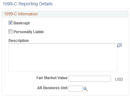

Use the 1099-C Reporting Details page (CUST_CREDIT_SEC) to enter customer cancellation of debt details.
Navigation:
This example illustrates the fields and controls on the 1099-C Reporting Details page. You can find definitions for the fields and controls later on this page.
Field or Control |
Description |
Bankrupt |
Select this check box if the customer is bankrupt. For reporting Receivables transactions such as write-offs as canceled debt, the Bankrupt check box must be selected or a Description must be entered. |
Personally Liable |
Select this check box if this customer is an individual and not a business entity. This information appears on the 1099-C form to be submitted to the IRS. |
Description |
If desired, enter a description of the canceled debt. This information appears on the 1099-C form to be submitted to the IRS. |
Fair Market Value |
Enter an amount in USD for the fair market value of the canceled debt, such as a foreclosure, to indicate that the canceled debt is not related to a Receivables transaction, such as a write-off. If you enter a value here, the system bypasses transactions associated with the control values identified on the Canceled Debt Report Setup page for this customer in Receivables and reports only this amount on the 1099-C form. |
AR Business Unit |
Required if you enter a fair market value amount. The business unit must be associated with a creditor on the Canceled Debt Creditor page. |

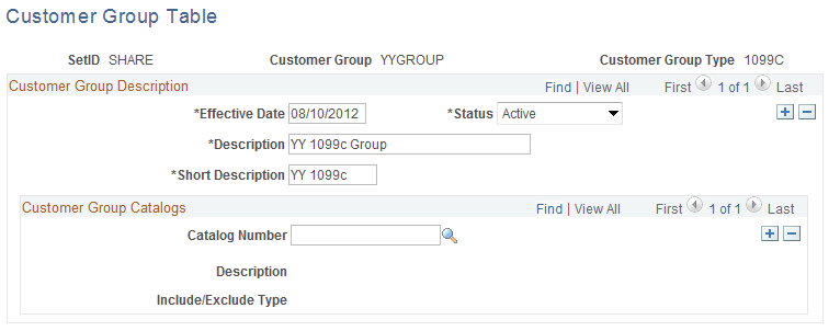

Creating a Canceled Debt Reporting Customer Group Table
Use the Customer Group Table search page (Set Up Financials/Supply Chain, Common Definitions, Customers, Customer Group Table).
To add a new customer group specifically for canceled debt reporting, follow these steps:
Select a SetID value.
Select Canceled Debt Reporting from the Customer Group Type list.
Add a Customer Group value, for example, USGROUP.
Click the Add button.
The Customer Group Table page for your new Customer Group appears.
This example illustrates the fields and controls on the Customer Group Table page. You can find definitions for the fields and controls later on this page.
Enter required values on the Customer Group Table page, including Effective Date, Description, and Short Description. In this example, the user has already saved these values.

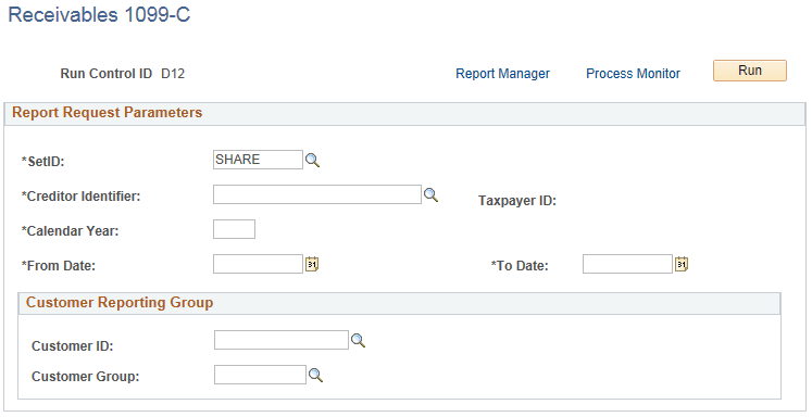

Use the Receivables 1099-C page (RUN_AR_1099C) to run control to create a preliminary table with data necessary for 1099-C reporting.
Navigation:
This example illustrates the fields and controls on the Receivables 1099-C page. You can find definitions for the fields and controls later on this page.
Field or Control |
Description |
SetID |
Select a SetID. Customer data used for reporting must be within this SetID value. You cannot report 1099-C information across SetIDs. |
Creditor Identifier |
Select the Creditor ID. This value determines the creditor information including taxpayer ID and address, as defined on the Canceled Debt Creditor page. This value also determines the Control ID as entered on the Canceled Debt Creditor page, which controls the type of data selected for the 1099-C report. The business units associated with the Creditor ID are the only business units that will be used to gather data for the customer's 1099-C report. Receivables business units can be associated with only one Creditor ID. You cannot create 1099-C reports that contain data across taxpayer IDs. |
Calendar Year |
Enter a four-digit value for the calendar year. All data selected for reporting are restricted to one calendar year. Any calendar year is valid. |
From Date and To Date |
Select a date range within the calendar year entered in the Calendar Year field. The data for reporting will be restricted to the selected date range. |
Customer Reporting Group |
Select the customers to be included in the record table from these options:
Enter the desired parameters and click the Run button to launch the AR_1099_PREP process to create the record table (AR_1099C_TBL) that will be used to submit records for the Cancellation of Debt report.

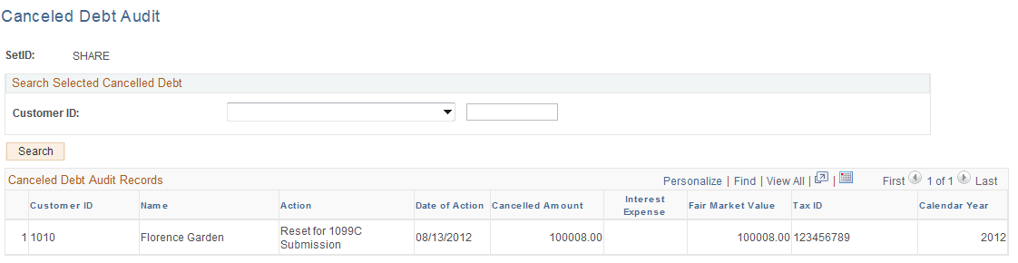

Use the Canceled Debt Audit page (AUDIT_AR_1099C) to search for and review 1099-C actions for one or more customers.
Navigation:
This example illustrates the fields and controls on the Canceled Debt Audit page. You can find definitions for the fields and controls later on this page.
If the Customer ID fields are blank when you click the Search button, the system displays all records on the audit table (AR_1099_AUD_TBL).
You can filter the Canceled Debt Audit Records by Customer ID in the Search Selected Canceled Debt box.
