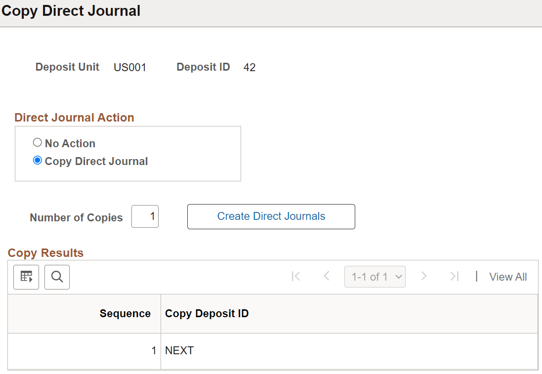

Use the Copy Direct Journal page (AR_DJ_COPY) to copy a direct journal. User needs to have permission lists EPAR0000 and EPAR4000 to access the Copy Direct Journal page.
The criteria for the eligible copy from direct journal are the following:
All the payments in the deposit must be Direct Journal payment.
The deposit does not contain unposted Direct Journal.
Deposit status is balanced.
Navigation:
This example illustrates the fields and controls on the Copy Direct Journal page. You can find definitions for the fields and controls later on this page.
Field or Control |
Description |
Direct Journal Action |
Select an action from the following available options:
Number of Copies |
Enter the number of copies required. Default value is 1 and the maximum number allowed is 99. |
Create Direct Journals |
Click to populate the Copy Results grid with number of rows based on the specified number of copies. Click Save to create the new Deposit ID based on the last Deposit ID value of the deposit BU on the Receivable Option page. |
Go to Direct Journal Acctg Entries |
Click to access the Direct Journal Accounting Entries page for the new Deposit ID. The link is enabled only when you click the Save button. |
If copy from deposit contains more than one direct journal payments, then all the payments in the deposit are copied over. The copied direct journal deposit/ payment accounting date will be the current date.
When you copy a completed Direct Journal, the copied Direct Journal is reset to the state it was before being marked as completed.
The following table data from the existing Direct Journal deposit/payment is copied to the new deposit/payment(s).

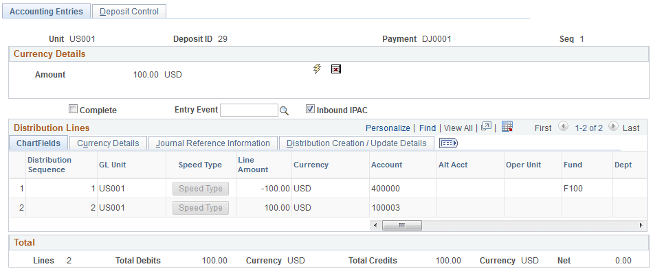

Use the Direct Journal Payments - Accounting Entries page (PAYMENT_MISC_DST) to create or change accounting entries for payments that are to be journaled directly.
If you use the Commitment Control option, use it to run the Budget Processor process.
Navigation:
This example illustrates the fields and controls on the Direct Journal Payments - Accounting Entries page. You can find definitions for the fields and controls later on this page.
Field or Control |
Description |
Click the Create icon to create the cash line for a direct journal payment. |
Click the Delete icon to delete journal lines. |
Inbound IPAC |
Select this check box if you want to be able to select this transaction for inbound IPAC processing. This field is displayed only if the IPAC check box is selected in the AR installation options and the customer is identified as a federal customer. Deselect this check box if the transaction was incorrectly selected for inbound IPAC processing. |
TAS and BETC Details |
Click to review the Treasury Account Symbol and BETC code on the TAS and BETC Details page (AR_TAS_MISC_SEC). See (USF) Reclassifying Receivables Accounting Entries, Direct Journal Accounting Entries, and Open Items for more information. The TAS and BETC values are available on the distribution lines by selecting the CTA check box on the Installation Options - Receivables Page. The TAS and BETC are derived using the Fund Code value on the accounting line. The Fund Code is a required field when the agency is a GWA Reporter for Receivables, and you must enter a Fund Code on the accounting lines. To view the TAS and BETC values, click the TAS and BETC Details link in the Distribution Lines grid on each accounting line. For CTA processing, Entry Events should be set up as required for Receivables. The system defaults the BETC based on the TAS value only when there is just one BETC code defined for Collections. When more than one collection BETC is defined, you select the BETC code from a dynamic prompt based on the TAS code. |
Create accounting entries.
Budget-check the entries.
Resolve budget-checking errors.
Creating Accounting Entries
To create accounting entries:
Enter ChartField values for the revenue line.
Note: If you have set up speed types for ChartFields, click the Speed Type button and select a speed type code. The system automatically supplies the General Ledger ChartField values defined by the speed type.
If you have enabled and set up accounting tags for ChartFields, click the Account Code and select an accounting tag. The system automatically supplies the General Ledger ChartField values defined by the accounting tag. See Setting Up Accounting Tags for more information.
In the Line Amount field, enter the credit amount for the revenue account.
Note: If you are journaling a negative payment, enter a debit amount.
Click the Create button to create the line that records the cash.
The system supplies the ChartField values using either the AR - Cash or DIT - Cash ChartFields that you defined for the bank account on the External Accounts page. It uses the DIT - AR ChartFields only if you selected the Dep in Transit (deposit in transit) check box for the bank account.
Project ChartFields other than Project Id, such as Business Unit PC, Activity Id, and more, are inherited to the offsetting cash accounting line if the inheritance option for Project Id is set to Always Inherit. If the inheritance option for Project Id is set to Do Not Inherit, then these Project ChartFields will not be inherited.
The system calls the Centralized Inter/IntraUnit Application Engine process (IU_PROCESSOR) to create intraunit accounting entries if you enabled ChartField balancing for the ledger group and interunit accounting entries, and if you are journaling the cash to a different business unit than the deposit business unit.
Note: After you create the cash line, you cannot change the ChartField values or amounts. To change this information, click the Delete button. The system deletes the cash line and makes the revenue ChartField values available to edit.
(Optional) If you enabled the Entry Event feature, enter the Entry Event code used to generate supplemental accounting entries.
(Optional) If you enabled the Document-Sequencing feature for the PeopleSoft General Ledger business unit, click the Document Sequencing button for each line to enter document-sequencing information.
After you enter all of the accounting lines and they are in balance, select the Complete check box.
Verify the edit status on the ChartFields tab.
The status can be:
Field or Control
Description
Not Edited
You have not saved the entries.
Errors
You saved the entries, but the system did not create them because they are in error.
Complete
You created valid accounting entries.
A single error message displays for a direct journal payment if at least one payment distribution line has a ChartField combo edit error. This message instructs the user to refer to the ChartField Combo Error tab for further details about the error.
The ChartField Combo Error tab displays in the Distribution Lines grid. This tab identifies the specific fields and combination group that was used to compare against the distribution line with the error. If there are no errors, this tab does not appear.
Correct the error and select the Complete check box again. If you receive a combination edit error, you must either change the ChartField combination or modify the combination edit rules. If you receive a ChartField configuration editing error message after you mark the entries complete, you must correct the error before you save the direct journal. If you receive a warning message, you can save the direct journal without making corrections.
Note: If you must change the accounting entries after you save them and before you run the Journal Generator process, deselect the Complete check box on the Directly Journalled Payments page. Then return to the Accounting Entries page to change the entries.

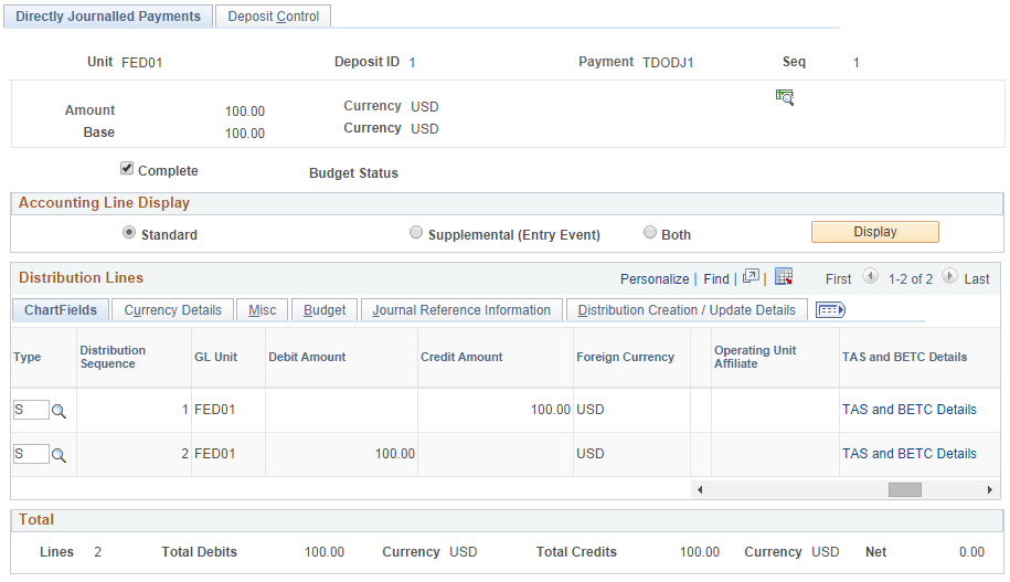

Use the Directly Journalled Payments page (PAYMENT_MISC_DST_I) to review directly journaled payments that have been marked Complete.
Also, change the Complete status to Incomplete. You can run the Budget Processor process to budget-check direct journal payments.
Navigation:
This example illustrates the fields and controls on the Directly Journalled Payments page. You can find definitions for the fields and controls later on this page.
This page is similar to the Accounting Entries page in the Pending Items component.
If you have not run the Budget Processor process and you have enabled commitment control for PeopleSoft Receivables and the business unit, you can run it from this page and review the results.
If a budget entry fails because you provided a revenue account that is not in the revenue estimate budget, you need to delete the accounting entries and enter them again using a different revenue account.
Field or Control |
Description |
Complete |
Deselect to delete and change the accounting entries for the payment. Then access the Accounting Entries page to make the changes. Important! If you deselect the Complete check box and commitment control records exist for this direct journal, they will be deleted. The system will only delete commitment control exception records, because at this point you can only deselect the check box for transactions that have not been budget checked or have failed budget checking. |
Accounting Line Display |
Specify the types of accounting entries that should appear, and then click Display. Values are Standard, Supplemental (Entry Event), and Both. Supplemental accounting entries are available only if you entered an entry event code on the Accounting Entries page. |
Type |
Indicates the type of accounting entries: S for Standard. E for Supplemental. |
Credit Amount and Debit Amount |
If the system displays the debits and credits separately, the Credit Amount and Debit Amount fields display the amounts in the base currency of the business unit. If you selected the Display Separate Debit/Credit in Subsystem check box on the Operator Preferences - Overall page, the debit amount or the credit amount and currency appear for each accounting line. Otherwise, the Line Amount field appears for each line. |
Click to review the Treasury Account Symbol and BETC code on the TAS and BETC Details page (AR_TAS_MISC_SEC). See (USF) Reclassifying Receivables Accounting Entries, Direct Journal Accounting Entries, and Open Items for more information. |

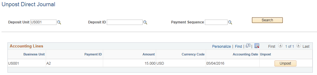

Use the Unpost Direct Journal Page (UNPOST_DIRJNL) to unpost payments that have been directly journaled.
Navigation:
This example illustrates the fields and controls on the Unpost Direct Journal page.
Search for direct journals that have already been posted, by deposit unit, deposit ID, and payment sequence. The results appear in the Accounting Lines grid.
Field or Control |
Description |
Unpost |
Click this button to create a new unpost activity and new distribution lines for each item that is unposted. You can then create a new deposit and select the option to journal the payment directly. |
To unpost a direct journal payment:
On the Unpost Direct Journal page, enter search parameters and click the Search button.
The results show deposits for which a direct journal has been posted.
Click the Unpost button for the payment you would like to unpost.
On the Direct Journal Review secondary page, check the budget status. The budget status must be Valid or the entries must be balanced. The Budget Check icon is only visible if Commitment Control is enabled for Receivables and the business unit.
Click OK to unpost the direct journal payment and create a positive payment.
If you want to post the new deposit to the general ledger, run the Journal Generator process.
Note: When you unpost a direct journal payment, the payment status changes to ‘Unposted DJ’ and the deposit becomes unavailable.
