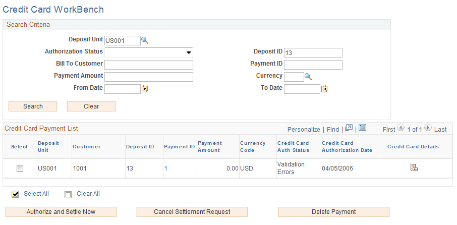

Use the Credit Card Workbench page (AR_CRCARD_WORKBNCH) to select credit card payments and perform mass actions on credit card payments.
Navigation:
This example illustrates the fields and controls on the Credit Card Workbench page. You can find definitions for the fields and controls later on this page.
| Field or Control | Description |
| Authorization Status | Select the authorization status of the credit card payments that will appear in the Credit Card Payment List area. Values are: Authorized and Billed Deleted after Settlement Denied Manually Approved/Settled No Action Pending Approval Processing Unprocessed/Retry Validation Errors Zero Payment for maintenance |
| From Date and To Date | Enter the date range that identifies when the credit card payments were created. |
| Search | Click to populate the Credit Card Payment List area with data based on the information entered in the Search Criteria region. |
| Clear | Click to clear the information in the Search Criteria region. |
| Payment ID | Displays the remit sequence for the item on the Credit Card Worksheet Application page. Click the link to access the Credit Card Worksheet Application page. |
| Credit Card Auth Status (credit card authorization status) | Displays the authorization status of the credit card payment. |
| Credit Card Authorization Date | Displays the date the authorization was received from the third party authorizing authority. |
| Authorize and Settle Now | Click to submit all selected credit card worksheets for authorization and settlement. Until the authorization and settlement process completes, the credit card worksheets are not available for selection, and they have a credit card authorization status of Processing. |
| Cancel Settlement Request | Click to cancel the settlement request for the selected credit card worksheets that have not been authorized and settled. This button sets the Credit Card Authorization Status to No Action. The canceled credit card worksheets are not selected by the Credit Card Processor, however, you can update a canceled credit card worksheet. |
| Delete Payment | Click to delete all selected credit card payments. The selected items in the worksheet are available for selection in other credit card worksheets. This option is only available for
 If the deposit does not contain any other payments, the system also deletes the deposit. If another payment exists in the deposit, the system subtracts the deleted payment amount from the deposit total. |
