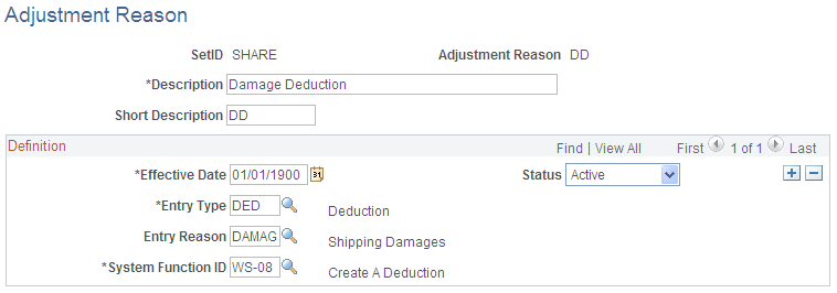

Use the Adjustment Reason page (ADJ_REASON_TABLE) to create adjustment reason codes for electronic payments, such as EDI, lockbox, and bank statements.
Navigation:
This example illustrates the fields and controls on the Adjustment Reason page. You can find definitions for the fields and controls later on this page.
Field or Control |
Description |
Entry Type and Entry Reason |
Assign an entry type and reason associated with the adjustment reason. For example, you can have one adjustment reason for product discount deductions and another for deductions for damaged goods. Each uses the same entry type but has a separate entry reason so that you can update a different account. If the Payment Loader Application Engine process (AR_PAYLOAD) cannot translate the adjustment reason code in the lockbox, EDI file, or bank statement, it uses the entry type, entry reason, and system function ID that you specified for the payment business unit on the Receivables Options - General 2 page. |
System Function ID |
Displays one of the system functions that is associated with the entry type. Override this value, which appears by default, if needed. |
