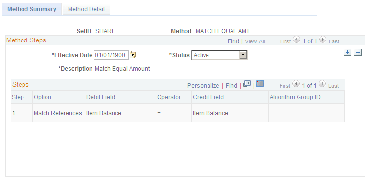

Use the Method Summary page (AUTOMNT_METHOD) to add a new automatic maintenance method or view a summarized list of the steps in an existing method.
Navigation:
Use the Method Summary page (Set Up Financials/Supply Chain, Product Related, Receivables, Credit/Collections, Automatic Maintenance Methods, Method Summary).
This example illustrates the fields and controls on the Method Summary page. You can find definitions for the fields and controls later on this page.
Field or Control |
Description |
Method |
Displays the unique code that identifies the automatic maintenance method. |
Steps
The Steps grid displays a list of all the steps in the automatic maintenance method. When you first add a new method, the list is blank.
Field or Control |
Description |
Step |
Displays the step number. The process performs the steps in sequential order. |
Option |
Displays the type of task that the step performs. Values are: Match: Matches the values in a field for a debit item to the value in a field for a credit item. Algorithm: Matches or creates a write-off based on the algorithm that you selected. Write-Off: Writes off debit or credit items that the process did not previously match that have an amount that is less than the defined tolerances for either the business unit, customer, or automatic maintenance reason associated with the automatic entry type for the write-off item, such as Write off a Debit or Write off a Credit. |
Debit Field |
Displays the field whose value you are matching for debit items. |
Operator |
Displays the operator that the process uses to match the items. Values are: = (equals): Creates exact matches. LIKE: Creates partial matches. |
Credit Field |
Displays the field whose value you are matching for credit items. |
Algorithm Group ID |
Displays the name of the Application Engine section that the process runs for the step. |

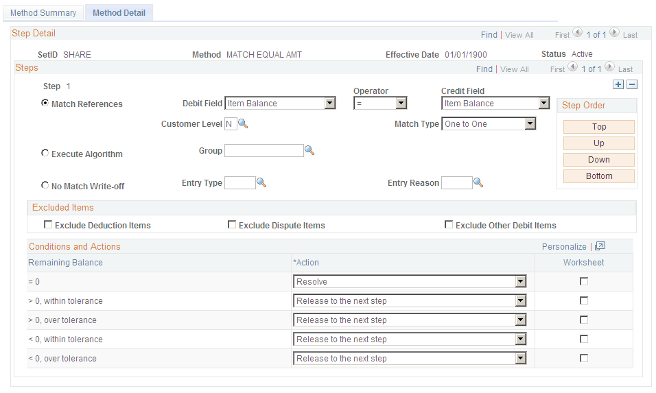

Use the Method Detail page (AUTOMNT_STEP) to define the steps that the Automatic Maintenance process performs when you run a method.
Navigation:
This example illustrates the fields and controls on the Method Detail page. You can find definitions for the fields and controls later on this page.
Steps
When the Automatic Maintenance process runs, it examines each debit item and performs the steps in the method in sequential order. The system automatically assigns the Step number.
Select one of these options for each step:
Field or Control |
Description |
Match References |
Matches the values in a field in a debit item to a value in a field in a credit item. For example, it could match the invoice for a debit item with the document ID for a credit item. When you select this option, you must specify the match criteria. |
Execute Algorithm |
Performs matching and write-offs defined in a Application Engine section. Each section is an algorithm group and each step in the section is an algorithm. The Automatic Maintenance process executes the actions based on the results of the algorithm. When you select this option, you must enter the name of the algorithm group in the Group field. Select a user-defined algorithm or select the system-defined #OLDEST algorithm, which matches all debits and credits in oldest first order by due date. |
No Match Write-off |
Writes off debit or credit items not matched by the previous steps that have an amount that is less than the tolerances that you defined. When you select this option, select one specific Entry Type and corresponding Entry Reason for the items that you want to write off. For example, enter DED for the entry type to write off deduction items. When you create the entry reason for the entry type, you might want to create the entry reason for a small amount, such as 5.00 USD. When you create an item, such as a deduction, assign the entry reason for small amounts to the item. Enter the entry reason for small amounts in the Entry Reason field. If you want to write off both debits and credits, you need to create two separate steps. Note: If you select No Match Write-Off for a step, the Automatic Maintenance process does not check the percentage tolerance, because the percentage will always be 100. |
If you selected Match References, specify the criteria for creating a match.
Field or Control |
Description |
Debit Field |
Enter the field whose values you want to match in debit items. |
Operator |
Select the operator to use for matching. Values are: =: Creates exact matches. LIKE: Creates partial matches, including values that begin with the same characters or numbers. For example, the process would match a debit whose reference ID is 123 to a credit whose reference ID is 12345, or it would match a debit whose reference ID is 12345 with a credit whose reference information ID is 123. However, it will not match 12345 to 12378. If you want to create both exact and partial matches, enter one step to create exact matches and one to create partial matches. Because like matches also retrieve exact matches, always precede a Like match step with an Exact match step. |
Credit Field |
Enter the field whose values you want to match in credit items. You can match values in the following fields in the Item table (PS_ITEM) for either the debit or credit items. The field for the credit does not have to be the same field as the debit. Select from these values: AR Specialist, Bill of Lading, Broker ID, Carrier ID, Claim Number, Class of Trade, Collector, Contract number, Credit Analyst, Item Balance (open amount), Division, Document ID, Family, Invoice, Item ID, Major Classification, Order No, Open Amount, Proof of Delivery, Purchase Order Reference, Sales Person, Sales Person 2, or User 1 through User 10. |
Customer Level |
You can expand match groups to include items across all customers in a customer group. Select the customer level to use when creating match groups. Values are: C: Corporate customer group. N: No customer relationships considered. This is the default value. R: Remit from customer group. |
Match Type |
Specify how the process does the matching. Select one of these values: All: Places all items that meet the matching criteria in one match group. One to One: Matches only one debit to only one credit in a match group. If the matching criteria creates a match group with more than one debit or credit, the process does not match them. Matches debit and credit items of the same amount for a customer as long as the amounts are unique. For example, if you select Item Balance as the matching criteria in both the Debit Field and the Credit Field, and there are two 1,000.00 USD debits and one 1,000.00 USD credit, it does not match the items. |
Exclude Deduction Items |
Select to exclude deduction items from matching when processing the step. |
Exclude Dispute Items |
Select to exclude disputed items from matching when processing the step. |
Exclude Other Debit Items |
Select to exclude all items other than deduction and disputed items from matching when processing the step. |
Step Order
The buttons in the Step Order group box move a step up or down in the method. Place the steps that produce the greatest number of matches at the beginning of the method.
Conditions and Actions
If you select Match References or Execute Algorithm, you must select an action for each condition. Each step includes five remaining balance conditions.
If you select No Match Write-off, the system defines the conditions and actions, and you cannot change them. However, you can specify whether you want to place the write-off items on a worksheet.
Field or Control |
Description |
Remaining Balance |
Displays the condition for the remaining balance for a match group. Values are: = 0: The remaining balance is zero. > 0, within tolerance: The remaining balance is greater than zero and meets the write-off tolerances. > 0, over tolerance: The remaining balance is greater than zero and exceeds the write-off tolerances. < 0, within tolerance: The remaining balance is less than zero and meets the write-off tolerances. < 0, over tolerance: The remaining balance is less than zero and exceeds the write-off tolerances. Note: You define the write-off tolerances for each business unit and override them for individual customers or for the automatic maintenance reason that you assign to the automatic entry types associated with these system functions: Write-off a Credit (MT-02), Write-off a Debit (MT-03), Write-off Remaining Credit (MT-06), and Write-off Remaining Debit (MT-07). |
Action |
Select the action that you want the process to perform based on the remaining balance for the group. Values are: Resolve: The process matches the entire amount of the items. Select this when the balance is zero. Resolve, write off balance: The process matches the items and creates a write-off item for the amount of the remaining balance. Select when the remaining balance is within tolerances. Resolve, Create new item: The process matches and closes the items and creates a new item (either an MD or MC item) for the difference between the balances of the matched items. For example, if the process matches debit items totaling $200 to credit Items totaling -$145, the items are closed and a new MD item is created for $55. If the process matches debit items totaling $200 to credit items totaling -$233, the items are closed and a new MC item is created for -$33. Resolve, Item balance open:The process matches the items and closes the items with the smaller total absolute amount. The process also closes the items with the larger total absolute amount, except for the item with the latest due date, which remains open with a balance equal to the difference between the two amounts. The process does not create a new item. For example, the process matches debit items totaling $200 to credit Items totaling -$145, the credit items are closed, and the debit items are closed, except for the debit item with the latest due date, which remains open with a balance of $55. Note: If you select the No Match Write-off button, the Resolve, Item balance open actions are not available for selection. Release to next step: The process does not match the items. The debit and credit items are available for processing in the next step. Select for either a zero balance or a remaining balance. |
Worksheet |
Select to place the match group on a maintenance worksheet for online review. The worksheet displays the match groups and suggested write-off items or remaining open amounts. You can accept the results or make manual adjustments before posting the maintenance group. Note: You can select Worksheet only for a Resolve, write off balance action for a No Match Write-Off step. |
