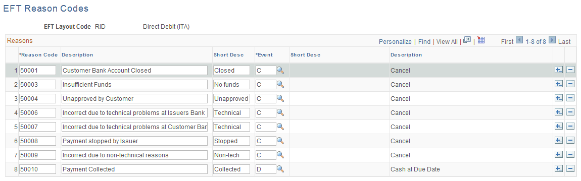

Use the EFT Reason Codes page (EFT_BANK_REASON) to set up reason codes for direct debit processing.
Navigation:
This example illustrates the fields and controls on the EFT Reason Codes page. You can find definitions for the fields and controls later on this page.

Set up the following reason codes for the RID files that are used in Italy. Other countries can use this as an example to set up their reason codes.
Reason Code |
Description |
Action |
50001 |
Customer bank account closed. |
Cancel direct debit. |
50003 |
Insufficient funds. |
50004 |
Unapproved by customer. |
50006 |
Incorrect due to technical problems at issuer bank. |
50007 |
Incorrect due to technical problems at customer bank. |
50008 |
Payment stopped by issuer. |
50009 |
Incorrect due to nontechnical reasons. |
50010 |
Payment collected. |
Apply cash. |
