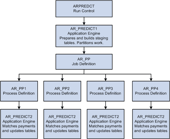

The following diagram illustrates how the Payment Predictor process performs parallel processing on four different AR jobs. The process prepares and builds staging tables and partitions the work into four different jobs, which are run parallel to each other. The Payment Predictor process for each job matches the payments and updates the tables.
Payment Predictor parallel process workflow for four different AR jobs: The process prepares and builds staging tables and partitions the work into four different jobs, which are run parallel to each other. The Payment Predictor process for each job matches the payments and updates the tables
When you use PeopleSoft Process Monitor to check the status of the process, you view the status of the AR_PREDICT1 process and each process within the AR_PP multiprocess job. The system does not indicate that the Payment Predictor multiprocess job (ARPREDCT) is successful until each parallel process finishes. The Job Message Log Summary page summarizes all the individual parallel-process message log messages for the entire ARPREDCT job.

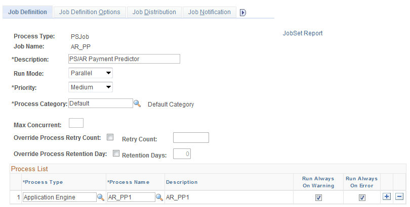

Use the Job Definition page (PRCSJOBDEFN) to add additional Payment Predictor process definitions to run the AR_PP multiprocess job.

This example illustrates the fields and controls on the Job Definition page.
Field or Control |
Description |
Run Mode |
Always select Parallel. |
Process Type and Process Name |
Enter Application Engine for the type and select from AR_PP2 to AR_PP8 for each separate partition or process that you want to run. If you define additional process definitions, select the name of the definitions that you added. Note: You must have the same number of rows in the process list as you enter in the Maximum Partitions field on the AR Parallel Processing Options page. |
Run Always on Warning and Run Always on Error |
You must select these check boxes. |
