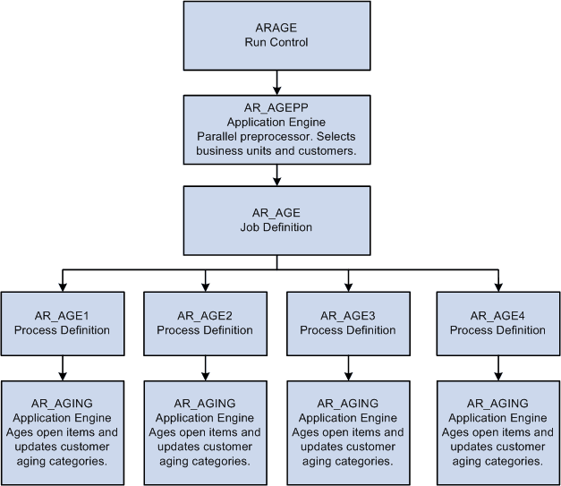

The following diagram illustrates the process flow of the AR Parallel Aging process (AR_AGE) for four separate AR jobs. After setting up the AR_AGE Run Control page, the AR_AGEPP Application Engine parallel preprocessor selects business units and customers, then the AR_AGE runs the job definition for the jobs AR_AGE1, AR_AGE2, AR_AGE3, and AR_AGE4. The AR_AGING Application Engine ages open items and updates customer aging categories for each job.
Process flow of the AR Parallel Aging process (AR_AGE) for four separate AR jobs
