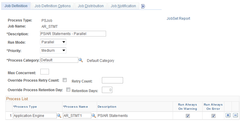

Use the Job Definition page (PRCSJOBDEFN) to add additional Statements process definitions to run the AR_STMT multiprocess job.
Navigation:
This example illustrates the fields and controls on the Job Definition page. You can find definitions for the fields and controls later on this page.
Field or Control |
Description |
Run Mode |
Always select Parallel. |
Process Type and Process Name |
Enter Application Engine for the type and select from AR_STMT2 to AR_STMT8 for each separate partition or process that you want to run. If you define additional process definitions, select the name of the definitions that you added. Note: You must have the same number of rows in the process list as you enter in the Maximum Partitions field on the AR Parallel Processing Options page. |
Run Always On Warning and Run Always On Error |
You must select these check boxes. |
