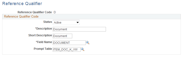

Use the Reference Qualifier page (AR_FLD_REF_TBL) to define new payment reference qualifiers that you will use to identify payment reference information and items when building worksheets.
Navigation:
This example illustrates the fields and controls on the Reference Qualifier page. You can find definitions for the fields and controls later on this page.

Field Name |
Select a field from PS_ITEM_ALL_PVN_VW that the remittance information references. |
Prompt Table |
Select a prompt record for the reference qualifier code, which the system uses to display an appropriate list when a user prompts on the field online. |
