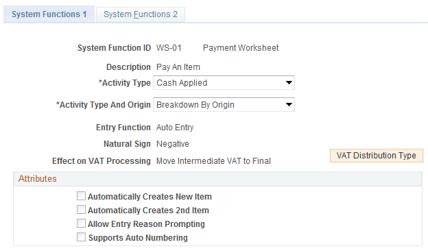

ENTRY_USE_TABLE |
View system function attributes, which enable the processing of a system function. PeopleSoft Receivables maintains these attributes, and you typically should not change them. |
ENTRY_VAT_PNL |
View the rules for updating the VAT tables during the Pending Group Generator Application Engine process (AR_PGG_SERV). |

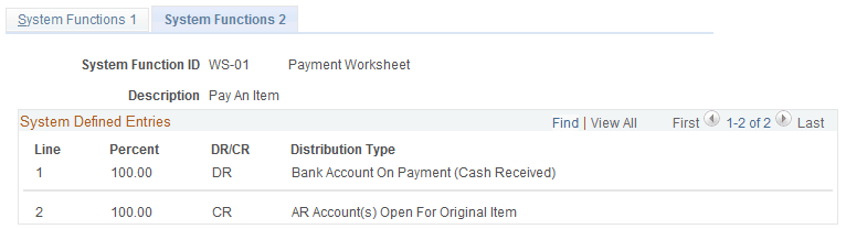

ENTRY_USE_TABLE2 |
Review the system-defined portion of the accounting entries. |
To define system functions, use the System Functions component (ENTRY_USE_TABLE).
Use this component to:
Select system function attributes.
Review rules for value-added taxes (VAT) processing.
Review system function accounting entries.

Use the System Functions 1 page (ENTRY_USE_TABLE) to view system function attributes, which enable the processing of a system function.
Navigation:
This example illustrates the fields and controls on the System Functions 1 page. You can find definitions for the fields and controls later on this page.
Field or Control |
Description |
Activity Type |
Select an activity type that indicates how system functions are classified. You must associate each system function with an activity type. You can assign an activity type to more than one system function. This structure determines how the system presents data on the Unit Activity page and the Unit Activity report. |
Activity Type And Origin |
When you view the inquiry page by activity type and origin, the system uses the Activity Type And Origin field to determine whether to break the category down by origin or bank code. This determines how the system displays information on the Unit Activity page. For example, suppose that you select Billing for the activity type and Breakdown By Origin for the Activity Type And Origin field. On the Unit Activity page, under Activity Type/Origin/Bank Code you will see that billing activity came from two different origins, OBILL and XBILL. The individual totals for each origin appear on the page. If you choose not to break down by origin, select Do Not Break Down By Origin for system functions IT-01 and IT-02. The Unit Activity page lists billing without an origin—meaning that the system has bundled together all the billing transactions, rather than breaking them into totals under their associated origin IDs. As another example, if you select Breakdown by Origin for the WS-01 system function, you will see a separate row for each bank account for the payment activity. If you select Do Not Break Down By Origin, all the payment activities are combined in one row. |
Entry Function |
Displays a system-defined value. It can be either Auto Entry (automatic entry) or Item Entry. Item entry types identify pending items created during online item entry or by an external interface. The system uses item entry types to handle processing when you directly build a pending item—during online entry or when an interface process constructs groups of pending items. When you enter or build pending items that make up a group, you use entry types that you have specifically enabled for use as item entry types. Item entry types take two forms:
Automatic entry types work in the background to translate instructions for overdue charging, payments, maintenance, transfers, direct debits, and drafts into pending items. When you initiate an online or background process for these types of groups (such as selecting an item on one of the worksheets, or running the Payment Predictor process or the Automatic Maintenance process), the system creates the necessary pending item using the information that you defined on the automatic entry type for that action. For example, every time you select an item for payment on the payment worksheet, the system uses the entry type, entry reason, and accounting entry information from the WS-01 (Pay An Item) automatic entry type to create the pending item. Automatic entry types fall into the following categories:
Natural Sign |
Displays a positive (+) or negative (–) sign, which. the system applies to pending items to determine the effect that a system function has on the customer balance. The only unsigned system functions are transfers, offsets, direct debits, and drafts (they can be said to offset an item), because their sign varies with the sign of the item being offset, transferred, or included in draft and direct debit processing. Debit memos must be positive, and credit memos must be negative. |
Effect on VAT Processing(effect on Value Added Tax processing) |
Indicates how VAT balances are adjusted for the system function. |
VAT Distribution Type (Value Added Tax distribution type) |
Click to view the account types that you selected for each declaration point for the system function. |
Automatically Creates New Item |
Displays the system setting. If this option is selected, the system creates a new item for activities that occur in the background. These system functions are all automatic entry types: new debits and credits, prepayments, on-account payments, deductions, and adjustments for overpayments and underpayments. |
Automatically Creates 2nd Item |
Displays the system-setting. If selected, it enables write-off of remaining debits and credits on the maintenance worksheet and by the Automatic Maintenance process, or write-off of overpayments and underpayments on the payment worksheet and draft worksheet, and by the Payment Predictor process. |
Allow Entry Reason Prompting |
Displays the system setting. If selected, it indicates that entry types tied to the system function can require an entry reason. Entry types define activity, and entry reasons enable you to further qualify the activity. So if a system function enables you to require an entry reason, you can generate reports, run aging, and view history at a greater level of detail. |
Supports Auto Numbering (supports automatic numbering) |
Displays the system setting. If selected, it enables you to enter a prefix and starting number for pending items. For example, these system functions could be assigned: PR: Prepayments. AO: Overpayment adjustments. AU: Underpayment adjustments. DE: Deductions. OA: On-account payments. |

Use the System Functions 2 page (ENTRY_USE_TABLE2) to review the system-defined portion of the accounting entries.
Navigation:
This example illustrates the fields and controls on the System Functions 2 page. You can find definitions for the fields and controls later on this page.
System-Defined Entries
The system-defined entries fall into one of two categories:
Two lines are defined: one for the accounts receivable entry and one for the cash entry.
In this case, the system generates a balanced accounting entry by itself. Cash system functions related to the payment worksheet, drafts, and direct debits fall into this category. Also, system functions related to the maintenance and transfer worksheet and the Automatic Maintenance process define two lines: one for the accounts receivable account and one for a control account.
A single line is defined: either a debit or credit for the accounts receivable entry.
Write-offs, discounts, and item entry system functions require two-sided accounting entries to be posted; therefore, you must create user-defined lines for the offsetting entries on your templates or during processing.
