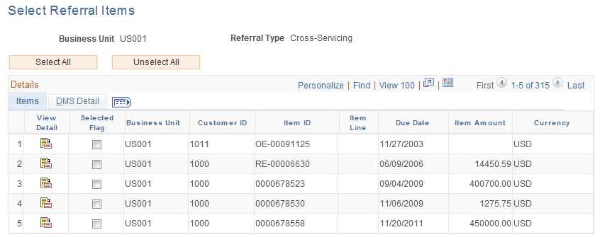

Use the Select Referral Items page (DMS_CONTROL) to select items to be referred to the DMS.
Navigation:
This example illustrates the fields and controls on the Select Referral Items page. You can find definitions for the fields and controls later on this page.
Select a business unit and referral type. The system processes one file for each business unit and referral type combination.
The page displays delinquent items for referral.
Viewing Item-Level Information
For each item listed in the grid, you can view the business unit, item ID, customer ID, and due date.
Field or Control |
Description |
Click the View Detail icon for an item to access the View/Update Item Details - Detail 1 page, and click the DMS Information link. Use the DMS Information page (DMS_ITEM_SEC) to update DMS (Debt Management Service) information for the item. |
Selected Flag |
Select to mark individual items for referral. |
