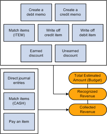

Most receivable functions that you perform update one of the two revenue buckets. In some cases, they update both. This diagram demonstrates that the functions create a debit memo, a credit memo, ITEM match items, a write-off credit item, a write-off debit item, an earned discount, and an unearned discount, all of which update the recognized revenue bucket. Direct journal entries, match cash items, and item payments update the collected revenue bucket.
