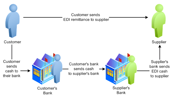

Typically both the cash information and the remittance advice are received through EDI, as shown in the following example in which the customer sends the EDI remittance directly to the supplier or the customer sends the cash to their bank, their bank sends cash to the supplier's bank, and the supplier's bank sends EDI cash to the supplier.
The customer sends the EDI remittance directly to the supplier or the customer sends the cash to their bank, their bank sends cash to the supplier's bank, and the supplier's bank sends EDI cash to the supplier
In this example, the customer sends you two EDI transmissions. The remittance advice is sent directly to you. The cash information is sent to the customer's bank, then to your bank, and then to you. As a result, you receive two separate EDI transmissions, one with cash and one with remittance information. You use split stream processing to match them and form the complete payment (linked cash and remittance information).

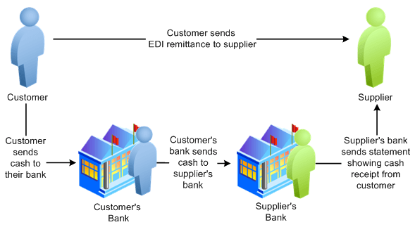

The common denominator for all methods of receiving split stream data is that the remittance information is received by EDI; only the source of the cash information varies. The method that customers use to send the cash to their bank or to your bank is irrelevant to split stream processing. Your only concern is how your bank transmits the cash information to you: as an EDI transmission, in a lockbox file or, as in the following example, as a receipt on a bank statement:
The bank transmits the cash information as an EDI transmission, in a lockbox file or, as in the example in the diagram, as a receipt on a bank statement

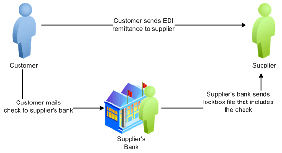

The following example shows transmission of cash information by way of a lockbox, where the customer sends an EDI remittance directly to the supplier or the customer mails a check to the supplier's bank, which sends a lockbox file, which includes the check, to the supplier.
Transmission of cash information by way of a lockbox, where the customer sends an EDI remittance directly to the supplier or the customer mails a check to the supplier's bank, which sends a lockbox file, which includes the check, to the supplier
U.S. and European business practices differ. In the United States, you usually receive payment in a lockbox file, but you are unlikely to receive payments from bank statements. In Europe, you probably do not use a lockbox, but you probably receive payments from bank statements.

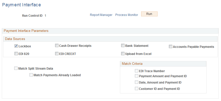

Use the Payment Interface page (PAYLOAD_REQUEST) to define the run parameters for the Payment Loader process and run the process.
Navigation:
This example illustrates the fields and controls on the Payment Interface page. You can find definitions for the fields and controls later on this page.
Field or Control |
Description |
EDI 820 |
Select if loading EDI data from the United States. |
EDI CREEXT |
Select if loading EDI data from a European country. |
Upload from Excel |
Select if loading payments from a Microsoft Excel spreadsheet. |
Match Split Stream Data |
Select to include split stream matching as part of the payment data load process. |
Match Payments Already Loaded |
Select to match remittance information with cash information that you already loaded into the payment application tables. |
EDI Trace Number (electronic data interchange trace number) |
Select if you receive both the cash and remittance by EDI. The transmissions have matching trace numbers. The trace numbers are unique, so the two pieces can be matched by using these criteria. |
Payment Amount and Payment ID |
Select if you require customers to include the payment ID (this could be the check number) and payment amount in the remittance advice. The cash and remittance are matched if they have the same payment amount and payment ID. |
Date, Amount and Payment ID |
Select if the customer includes the payment date on the remittance. European companies use Value Date as an additional matching field. (Estimated and actual value dates determine the float.) In the United States, use the accounting date of the payment. The cash and remittance are matched if they have the same date, amount, and payment ID. |
Customer ID and Payment ID |
Select if the cash has a magnetic ink character recognition ID (MICR ID) with it and the remittance has a customer ID. The cash and remittance are matched if they have the same payment ID and the cash MICR ID points to the remit from customer ID that is on the remittance. |
