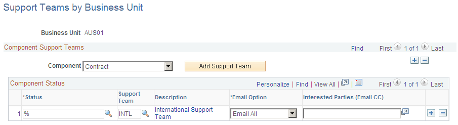

Use the Support Teams by Business Unit page (CA_EMAIL_BU) to define the support teams to be used for the workflow that you associate with the different activities within PeopleSoft Contracts.
Navigation:
This example illustrates the fields and controls on the Support Teams by Business Unit page. You can find definitions for the fields and controls later on this page.
