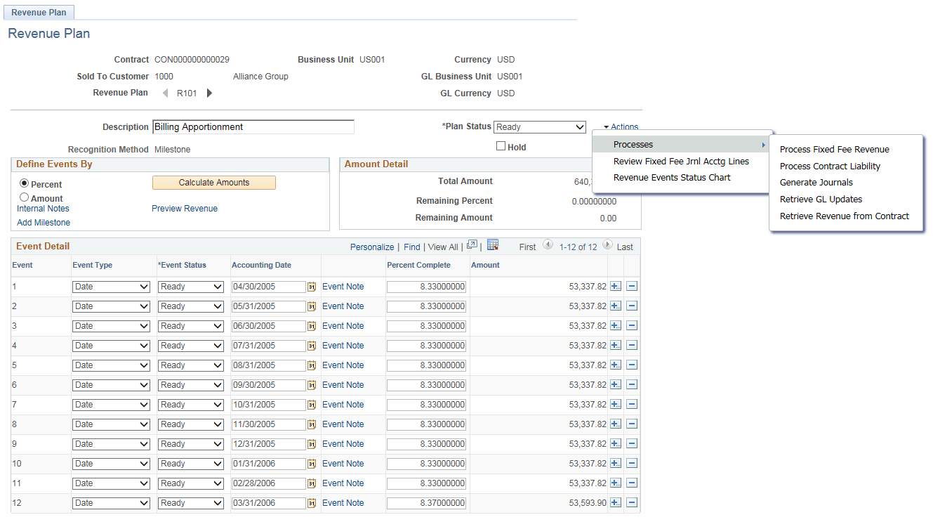

Use the Revenue Plan page (CA_ACCTPLAN) to define a revenue plan for contract lines in which revenue is managed by PeopleSoft Contracts.
Navigation:
This example illustrates the fields and controls on the Revenue Plan page. You can find definitions for the fields and controls later on this page.
Note: Defining a revenue recognition event is optional for revenue plans with a revenue recognition method of As-incurred. If you choose to define an event, the as-incurred revenue recognition method limits you to one Ready event at a time.

Actions |
Click and select related action from the respective folder shown in the related action widget pop-up menu. Options are:
Note: Related action widget will be available when the Revenue Plan Status is Ready. Based on the revenue method related actions available in the related action widget will vary. Revenue Events Status Chart will be available only for Milestone and Apportionment revenue methods. |
Below is the list of related actions that are accessed using the related action widget for Process option. Each related action when selected opens in a new window.
Related Action Widget |
Components |
Process |
Revenue Events Status Chart |
Pivot Grid Drill down |
Pivot Grid Detail View |
Review Journal Accounting Lines |
Note: Based on the revenue method the related actions available in the related action widget will vary.
