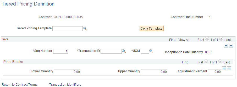

Use the Tiered Pricing Definition page (PC_TIER_DEFN) to specify a tiered pricing structure for a contract line.
Navigation:
Click the Tiered Pricing link on the Related Projects page.
This example illustrates the fields and controls on the Tiered Pricing Definition page. You can find definitions for the fields and controls later on this page.
Field or Control |
Description |
Tiered Pricing Template |
Select an existing tier template to facilitate data entry for your contract line. If you do not select a value here, you can specify specific tier information in the Tiers group box below. |
Copy Template |
Click to copy the details from the template you selected in the Tiered Pricing Template field into the Tiers group box below. When you click this button, the system warns you that copying from a template will overwrite any existing tiered pricing defined for the contract line. After selecting a template and copying the data into the Tiers group box, you can modify the tiered pricing definition. |
Tiers
Field or Control |
Description |
Seq Number (sequence number) |
Indicates the arbitration resolution order. This number represents the priority of the tier in the event that a transaction matches more than one transaction identifier. |
Transaction ID |
Select an identifier for the tier. The transaction identifiers includes combinations of values for the source type, source category, and source subcategory. |
UOM (unit of measure) |
Select a unit of measure for the quantities in the Price Breaks group box. |
Inception to Date Quantity |
Displays the total of all quantities processed to date for the tier. This is a display-only value that is specific to the tier and not to a particular price break. |
Price Breaks
Field or Control |
Description |
Lower Quantity |
Displays the minimum quantity required for the price break. For the first price break within a tier, this value will be 0. |
Upper Quantity |
Displays the maximum quantity allowed for the price break. The price break includes the value designated in the Upper Quantity field. Therefore, if the upper quantity is set to 20, the price break would extend up to and include a quantity of 20. Each tier must contain a price break with an upper quantity of 999999999999.99 |
Adjustment Percent |
Displays the increase or decrease to apply to the rate plan or contract-specific determined rate. |
