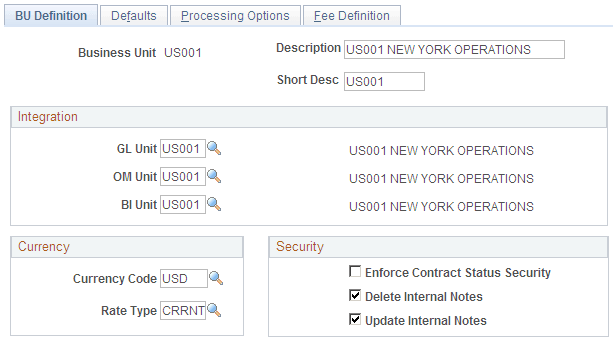

Use the Contracts Definition - BU Definition (contracts definition - business unit definition) page (BUS_UNIT_TBL_CA) to create a new PeopleSoft Contracts business unit definition or manage an existing business unit.
Navigation:
This example illustrates the fields and controls on the Contracts Definition - BU Definition page. You can find definitions for the fields and controls later on this page.
Field or Control |
Description |
Business Unit |
When you first add a business unit, you must provide a description and specify a value in the Default SetID field. |
Default SetID |
Enter a new SetID or select an existing one. If you are establishing a PeopleSoft Contracts business unit with the same name as one that is already set up in PeopleSoft General Ledger or PeopleSoft Receivables, the description is automatically populated, and this field does not appear. |
Create BU |
Click to create the new business unit. The system automatically creates default relationships between the business unit and the default SetID. If you have already set up a PeopleSoft General Ledger or PeopleSoft Receivables business unit with the same name, this button does not appear. |
Integration
Field or Control |
Description |
GL Unit |
Associate each PeopleSoft Contracts business unit with a PeopleSoft General Ledger business unit. PeopleSoft General Ledger business units define the accounting processing for associated PeopleSoft Contracts business units. All contracts created for this PeopleSoft Contracts business unit use this PeopleSoft General Ledger business unit to generate entries that interact with PeopleSoft General Ledger. |
OM Unit |
Select a default PeopleSoft Order Management business unit for contracts created under this PeopleSoft Contracts business unit. You can only select PeopleSoft Order Management business units that are linked to the same PeopleSoft General Ledger business unit as this PeopleSoft Contracts business unit. |
BI Unit |
Select a default PeopleSoft Billing business unit for contracts created under this PeopleSoft Contracts business unit. You can only select PeopleSoft Billing business units that are linked to the same PeopleSoft General Ledger business unit as this PeopleSoft Contracts business unit. |
Currency
Field or Control |
Description |
Currency Code |
Select the currency code that will appear by default as the contract currency on contracts created using this business unit. |
Rate Type |
Select the group of exchange rates used to convert contract currency amounts to the base currency of the PeopleSoft General Ledger system. You set up rate types when defining your general options. |
Security
Field or Control |
Description |
Enforce Contract Status Security |
Select to limit the list of users who can change the status of a contract to only those to whom you have given security access on the User Preferences - Contracts page. |
Delete Internal Notes |
Select to enable users to delete internal notes. |
Update Internal Notes |
Select to enable users to update internal notes. |

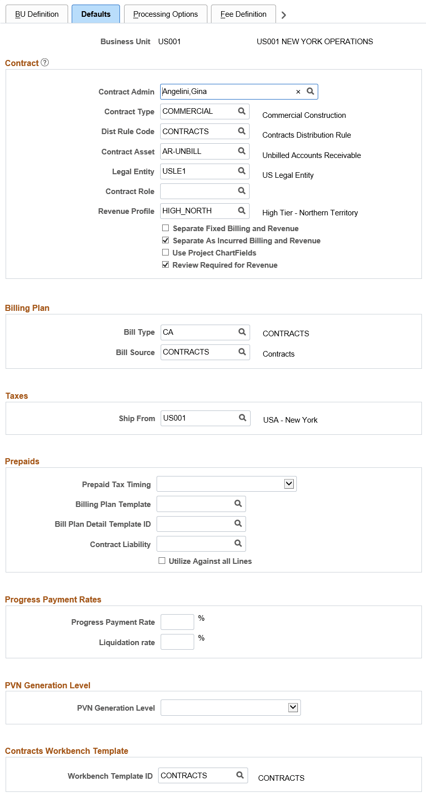

Use the Contracts Definition - Defaults page (BUS_UNIT_TBL_CA1) to define field value defaults for contracts created in this business unit. Information entered here defaults to the contract when it is added.
Navigation:
This example illustrates the fields and controls on the Contracts Definition Defaults page. You can find definitions for the fields and controls later on this page.
Contract
Field or Control |
Description |
Contract Admin (contract administrator) |
Select a contract administrator for this business unit. This value automatically populates the contract administrator field on the contract header. |
Contract Type |
Select a value to categorize the contracts for reporting purposes. |
Dist Rule Code (distribution rule code) |
Select the distribution rule code for the business unit. The distribution rule code identifies the distribution rules to use for a particular product when the product is selected onto the contract within this PeopleSoft Contracts business unit. You can define any number of combination criteria and hierarchy for the distribution rules. These rules tell the system how to identify and in what order to apply the accounting distribution sets. |
Contract Asset |
When you manage revenue from PeopleSoft Contracts, revenue is booked to a contract asset account. When billing occurs, PeopleSoft Billing generates an offsetting entry. The system uses this contract asset account as the high-level default value for every contract entered in this business unit. Note: If contract liability is enabled at the installation options level, a contract asset entry is generated, and liability is moved from the contract when booked. |
Legal Entity |
Select a legal entity for this business unit. While this legal entity is not directly linked to the legal entity in PeopleSoft General Ledger, this field allows you to capture which legal entity contracted with the customer on each contract. This value, which is a default on the contract, can be overridden. This value automatically populates the appropriate field on the contract header. |
Separate Fixed Billing and Revenue |
Select to define and apply different amounts for billing and revenue on amount based and percent based contract lines. The value for this field is defaulted from the Installation Options - Contracts page and can be overridden. The value for this field will default to the contract when a contract is added for this business unit, but can be overridden while adding a contract. |
Separate As Incurred Billing and Revenue |
Select to define and apply different rates for billing and revenue on rate-based contract lines. The value for this field is defaulted from the Installation Options - Contracts page and can be overridden. The value for this field will default to the contract when a contract is added for this business unit, but can be overridden while adding a contract. This field will be set to checked for government contracting entities that previously opted to separate billing and revenue at the installation level. |
Use Project ChartFields |
Select this check box to enter Project ChartFields on the contract line accounting distribution pages. This field is not visible if PeopleSoft Project Costing is not installed. |
Review Required for Revenue |
This check box is displayed and editable if Project Costing is installed and the Review Required for Billing check box is selected on the Installation Options - Project Costing Integration page. The value for this field will default to the contract when a contract is created for this business unit. The selection on the contract controls whether or not users may recognize revenue on project costing transactions not yet reviewed and approved on the Manager Transaction Review page. When Review Required for Billing is selected, users have an option to either require a review for revenue before revenue recognition (check box selected) or to bypass a review (check box not selected) in which case project costing transactions will be included in revenue recognition before being reviewed on the Manager Transaction Review Page. See Contract - General Page |
Contract Role |
Select suitable value from the prompt list. The value selected here will default to the contract, but can be overridden. |
Revenue Profile |
Select from the available values in the prompt list. The value selected here will default to the contract. |
Billing Plan
Field or Control |
Description |
Bill Type |
Select a default bill type for contracts created under this PeopleSoft Contracts business unit. The bill type represents the category of activity being billed. |
Bill Source |
Select to enable PeopleSoft Billing to identify where the billing activity came from and then to associate default billing information with that billing activity. |
Taxes
Field or Control |
Description |
Ship From |
Select from location codes defined on the Location Definition page. This value is used as a default for each contract but can be overridden on the billing plan. The system uses the ship from value as a portion of the location information that determines value-added tax. |
Prepaids
You can enter values at the business unit level to populate by default onto the Prepaid component for prepaid setup.
Note: Prepaid defaulting applies to new prepaid billing plans only. If you change these values at the business unit level, the system does not update existing billing plans to which the changed business unit applies. The new values apply only to new billing plans that are created on this business unit.
Field or Control |
Description |
Prepaid Tax Timing |
Select the timing of when prepaids are taxed. Select from Tax on Initial Bill or Tax on Utilization. This value appears by default on the prepaid setup for contracts created using this business unit. You can override this value on the prepaid setup pages. |
Billing Plan Template |
Select a billing plan template to associate with the prepaid contract line. The billing plan template automates the creation of the billing plan. |
Bill Plan Detail Template |
Select a billing plan detail template to associate with the prepaid contract line. Use the billing plan detail template to override the billing defaults that are defined for a contracts billing business unit and contract header. Note: If you want to select a billing plan detail template, you must also select a value in the Billing Plan Template field. |
Contract Liability |
Select the contract liability distribution code to associate with the prepaid contract line. Booking to contract liability enables you to post to the general ledger revenue that you expect to realize in a future accounting period. |
Utilize Against All Lines |
Select this check box to apply the prepaid towards all contract lines. Note: If you want to apply the prepaid against a specific contract line, you must enter the contract line manually in the Prepaid component. |
Progress Payment Rates
Field or Control |
Description |
Progress Payment Rate |
Enter the progress payment rate percentage that you wish to use for your government contracts. This value appears by default on the Progress Payment Terms - General page and can be overridden. |
Liquidation Rate |
Enter the progress payment liquidation rate percentage that you wish to use for your government contracts. This value appears by default on the Progress Payment Terms - General page and can be overridden. |
Note: The data in this group box only applies to contracts with a classification of Government.
Contracts Workbench Template
Field or Control |
Description |
Workbench Template ID |
Enter the template ID that the system uses when a user views the Contracts Workbench for this business unit. The system uses the records and fields in the Contracts Workbench that are selected for this template. The only templates that are available to choose from are those where Contracts was selected in the Workbench Type field. PeopleSoft delivers the CONTRACTS template, which is the default template for all Contracts business units. |

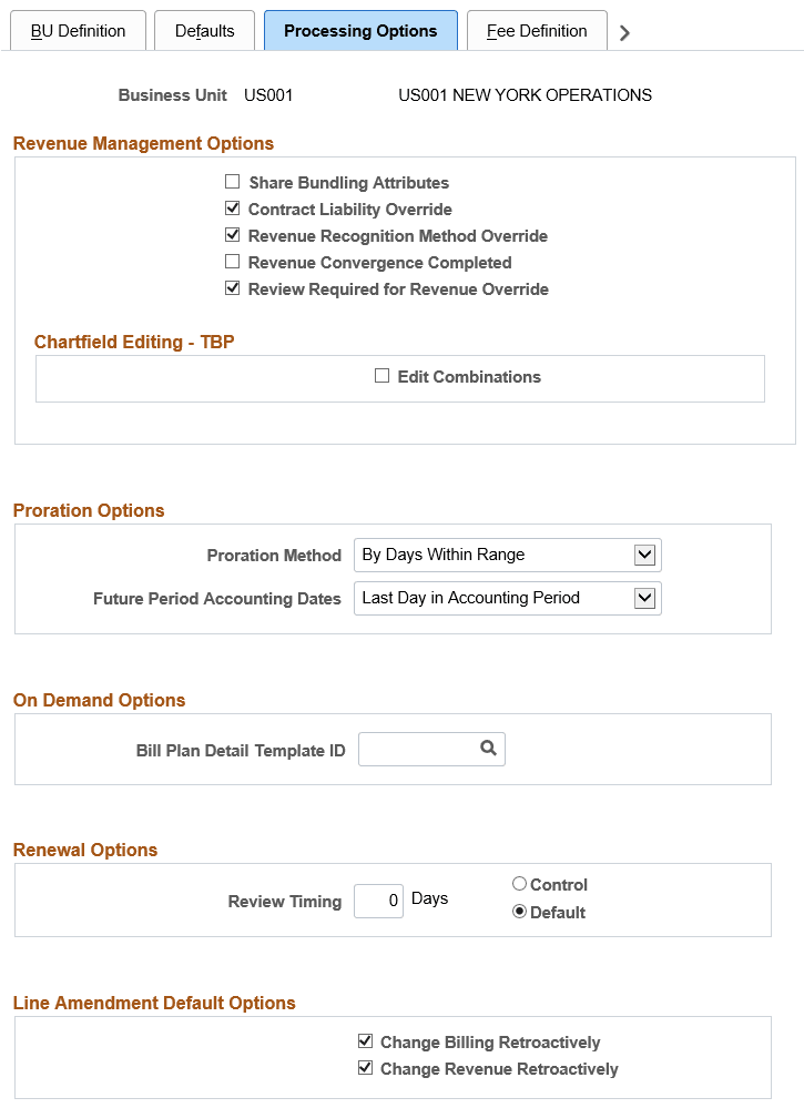

Use the Contracts Definition - Processing Options page (BUS_UNIT_TBL_CA2) to incorporate flexibility and automation in your PeopleSoft Contracts system to support revenue recognition and billing.
Navigation:
This example illustrates the fields and controls on the Processing Options Page. You can find definitions for the fields and controls later on this page.
Revenue Management Options
Field or Control |
Description |
Share Bundling Attributes |
Select the check box to share bundling attributes across contracts in the business unit. When selected, the bundling attributes defined on the Bundling Attributes Page are available for the contracts created in this Business Unit. When not selected, bundling attributes on the contract are contract specific and cannot be shared. |
Contract Liability Override |
Select to indicate whether a user can override the contract liability option on the contract line. At the product group level, you specify whether to use contract liability for a product group. The product group attributes for contract liability appear by default on the contract line. If you select this contract liability override option at the business unit level, you can override the contract liability option that automatically populates from the product group. Therefore, if you do not turn on contract liability at the product group level, you can still select it at the contract line level as long as you selected the contract liability override option at the business unit level. If you do not select this check box and contract liability is not specified for a product group, the contract liability option is unavailable for the contract line, and the Contract Liability tab does not appear. Booking to contract liability enables you to post to the general ledger revenue that you expect to realize in a future accounting period. If a contract is in Pending status, you can enable or disable contract liability at the contract line level. If a contract is in Active status, you cannot change this setting on the contract line and you must use amendment processing. However, you can use amendment processing to enable or disable only if this override is selected and if no contract liability or revenue processing has occurred. |
Revenue Recognition Method Override |
The contract line inherits its revenue recognition method from the product definition. Select this override check box to enable users to change the revenue recognition method on a contract line. When this override check box is not selected, the system processes the revenue for the contract line by the default revenue recognition method. |
Revenue Convergence Completed |
Select this check box after contracts have been transitioned to the new accounting standard. After doing so, data entered on the Contract General page for Revenue Transition will be hidden. |
Review Required for Revenue Override |
Select the check box to allow users to change the Review Required for Revenue option on the contract. This check box is displayed and editable if Project Costing is installed and the Review Required for Billing check box is selected on the Installation Options - Project Costing Integration page. |
Edit Combinations |
Select the Edit Combinations check box if you want the Accounting Rules Process (PSA_ACCTGGL) to run the combination edit process for transactions processed by the PeopleSoft Transaction Billing Processor. Note: The Edit Combinations feature is only used by the PeopleSoft Transaction Billing Processor. |
Proration Options
Field or Control |
Description |
Proration Method |
Provides the rules that the system uses to determine how much to apportion to each event for revenue plans with a revenue recognition method of apportionment. Select from:
Future Period Accounting Dates |
Stipulate the date that should be used as the accounting date for apportionment revenue recognition events. Select from:
On Demand Options
Field or Control |
Description |
Bill Plan Detail Template ID |
Select a bill plan detail template ID to override the fields on the billing plan for on-demand contracts. If you select a template on this page, the billing plan detail template overrides the corresponding fields on the billing plan when a billing plan is created through Contract's integration with the PeopleSoft Transaction Billing Processor. |
Note: This group box is for on-demand transactions only.
Renewal Options
Field or Control |
Description |
Review Timing |
Enter a value from 0– 999 in days. The system uses this value to determine when you must begin reviewing renewable contract lines. You can override this value for each renewable contract line on the Review Renewals page using either the control or default settings that you select on this page. |
Control |
Select the Control option to enable users to override the Review Timing Days field on the Review Renewals page with a value that is greater than or equal to the value entered in the Review Timing field. |
Default |
Select the Default option to enable users to override the Review Timing Days field on the Review Renewals page with a value that is less than, greater than or equal to the value entered in the Review Timing field. |
Line Amendment Default Options
Here are the Default Adjustment Options for Amending a line:
Field or Control |
Description |
Change Billing Retroactively |
Select this option to enable the system to adjust billing events retroactively when a contract line is cancelled or the contract line amount is modified during amendment processing. The option selected at the business unit level can be overridden at the contract line level. If this option is not selected at the business unit or contract line level, the user can only adjust any remaining future events for the contract line. |
Change Revenue Retroactively |
Select this option to enable the system to adjust revenue events retroactively when a contract line is cancelled or the contract line amount is modified during amendment processing. The option selected at the business unit level can be overridden at the contract line level. If this option is not selected at the business unit or contract line level, the user can only adjust any remaining future events for the contract line. |
