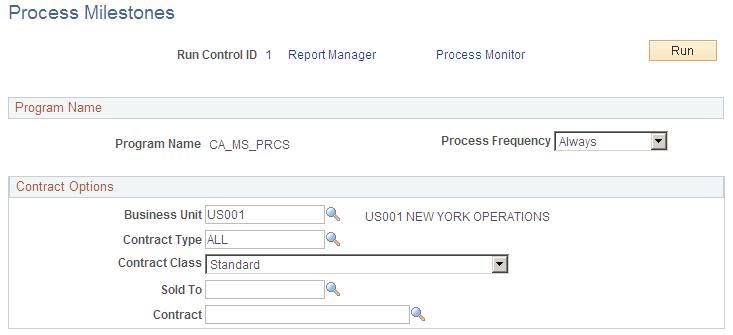

Use the Process Milestones page (RUN_CA_MSTONE) to update milestone condition statuses from Ready to Completed for Milestone, Date, and SQL type conditions meeting the parameter criteria that you specify.
This process also updates milestone statuses based on their conditions.
Navigation:
This example illustrates the fields and controls on the Process Milestones page. You can find definitions for the fields and controls later on this page.
Enter values in any of the fields on this page to filter the milestones that you want the system to process. Filter by PeopleSoft Contracts business unit, contract type, contract classification, sold to customer, or contract number. If you leave all fields blank, the process picks up all available milestone activity in PeopleSoft Contracts.
