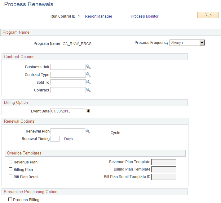

Use the Process Renewals page (RUN_CA_RENEWALS) to initiate the Renewals process for automatic renewals.
Navigation:
This example illustrates the fields and controls on the Process Renewals page. You can find definitions for the fields and controls later on this page.
Note: You can process only renewals with a renewal action of Automatic from this page. You process renewals with a renewal action of Manual from the Define Renewal Cycle page.
Contract Options
Use the fields in this group box to limit the renewals data that is included in the run of this process. Filter by PeopleSoft Contracts business unit, contract type, sold to customer, or contract number. If you leave all fields blank, the process picks up all available renewals activity in PeopleSoft Contracts.
Billing Option

Renewals Options
Use the fields in this group box to limit the renewals data that is included in the run of this process. If you leave all fields blank, the process picks up all available renewals activity in PeopleSoft Contracts.
Field or Control |
Description |
Renewal Plan |
Select a renewal plan to run the Renewals process for a specific renewal plan. The fields in the Contract Options group box are based on the target contract defined in the renewal plan. |

Override Templates
Field or Control |
Description |
Revenue Plan |
Select this check box to override any previously defined revenue plan template for the renewal plan. If you select this check box, the Renewals process uses the revenue plan template that you specify in the Revenue Plan Template field on this page to create the revenue plan for the new contract line. |
Revenue Plan Template |
Select a revenue plan template for the Renewals process to use to create the revenue plan for the new contract line. The revenue plan template that you define here overrides any previously defined revenue plan template for the renewal plan. If you do not select a revenue plan template here, the Renewals process uses the revenue plan template previously defined for the renewal plan to create the revenue plan. If no revenue plan template was previously specified for the renewal plan and you do not select one here, the Renewals process uses the revenue plan template defined for the product to create the revenue plan for the new contract line. |
Billing Plan |
Select this check box to override any previously defined billing plan template for the renewal plan. If you select this check box, the Renewals process uses the billing plan template that you specify in the Billing Plan Template field on this page to create the billing plan for the new contract line. |
Billing Plan Template |
Select a billing plan template for the Renewals process to use to create the billing plan for the new contract line. The billing plan template that you define here overrides any previously defined billing plan template for the renewal plan. If you do not select a billing plan template here, the Renewals process uses the billing plan template previously defined for the renewal plan to create the billing plan. If no billing plan template was previously specified for the renewal plan and you do not select one here, the Renewals process uses the billing plan template defined for the product to create a billing plan for the new contract line. |
Bill Plan Detail |
Select this check box to override any previously defined billing plan detail template for the renewal plan. If you select this check box, the Renewals process uses the billing plan detail template that you specify in the Billing Plan Detail Template field on this page to define the billing overrides in the billing plan for the new contract line. |
Bill Plan Detail Template ID |
Select a billing plan detail template ID. The Renewals process uses the values defined in this template for the Billing Overrides in the billing plan for the new contract line. The billing plan detail template that you define here overrides any previously defined billing plan detail template for the renewal plan. If you do not select a billing plan detail template here, the Renewals process uses the billing detail plan template previously defined for the renewal plan to define the billing overrides in the billing plan. If no billing plan detail template was previously specified for the renewal plan and you do not select one here, the Renewals process uses the billing plan detail template defined for the product for the new contract line. |
Streamline Processing Option
Field or Control |
Description |
Process Billing |
Select to have the Renewals process call the streamline billing process for renewals. If you select this check box and at least one billing plan with a Ready status is associated to the new contract line, the Renewals process will schedule the Contracts to Billing Interface (CA_BI_INTFC) process after all the contract lines are renewed. |
