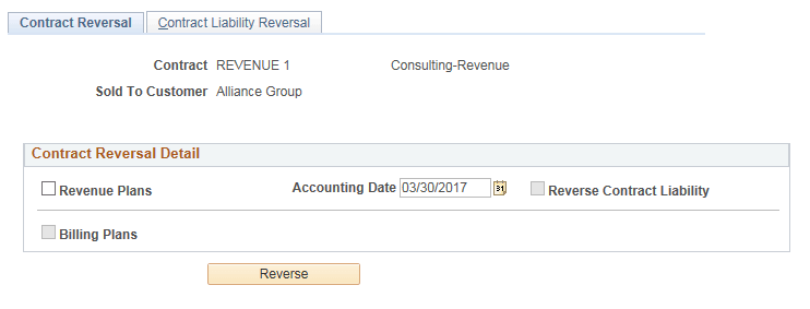

Use the Contract Reversal page (CA_REVERSE_HDR) to reverse all accounting entries created for a specific amount-based (price type of amount or percent) contract.
You can also reverse billing for an entire contract.
Navigation:
This example illustrates the fields and controls on the Contract Reversal page. You can find definitions for the fields and controls later on this page.
Contract Reversal Detail
Field or Control |
Description |
Revenue Plans |
Select this check box if you want to reverse revenue for all amount-based revenue plans associated with this contract. |
Accounting Date |
Displays the date on which reversal entries are booked. |
Reverse Contract Liability |
Select this check box if you want to reverse the contract liability associated with this revenue plan. This check box is available if your contract contains lines with contract liability already processed. |
Billing Plans |
Select this check box if you want to reverse billing for all billing plans associated with this contract. The system generates bills with credit amounts only for billing plans with a method of Percent Complete, Milestone, and Immediate. |
Reverse |
Click this button to enable the system to reverse revenue plans in a status of In Progress or Complete. |

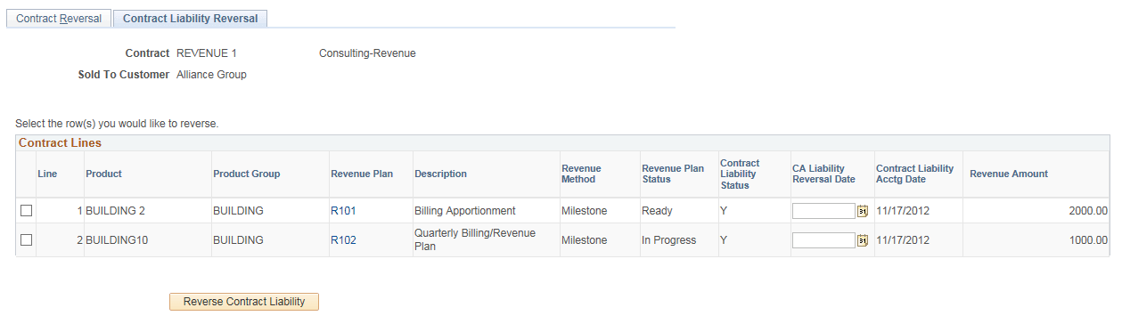

Use the Contract Liability Reversal page (CA_REVERSE_DFR) to reverse contract liability accounting entries created for a specific amount-based (price type of amount or percent) contract.
Navigation:
This example illustrates the fields and controls on the Contract Liability Reversal Page. You can find definitions for the fields and controls later on this page.
Select the contract liability rows that you want to reverse for this contract.
Field or Control |
Description |
Revenue Plan |
Click the link to access the revenue plan for this contract line. |
Revenue Method |
Displays the associated revenue method for this contract line. |
Revenue Plan Status |
Displays the associated revenue plan status for this contract line. |
Contract Liability Status |
Displays the contract liability status for the contract line. When you reverse contract liability, the system sets the status to Reversal Initiated. |
Contract Liability Reversal Date |
Displays the date on which you processed the contract liability reversal. |
Contract Liability Acctg Date |
Displays the contract liability accounting date. For a contract line, this is the contract sign date. For an amendment, this is the amendment date. For renewals, this is the renewal cycle start date. Once you reverse contract liability , the system clears this field and it remains blank. |
Revenue Amount |
Displays the revenue amount of contract liability for this contract line. |
Click to reverse the contract liability for the selected contract lines. |
Note: For contract lines that the system has begun processing revenue, you cannot reverse the contract liability unless you also reverse the revenue.
