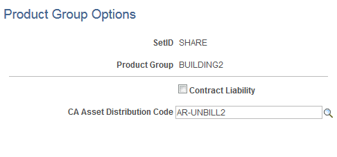

Use the Product Group Options page (CA_PROD_GROUP) to assign contract attributes such as contract liability and contract asset options for product groups.
Navigation:
This example illustrates the fields and controls on the Product Group Options page. You can find definitions for the fields and controls later on this page.
Select default attributes for the product group. The system populates the contract lines for any products assigned to this product group with the default values that you enter here.
Field or Control |
Description |
Contract Liability |
Indicate your contract liability option for the product group. The option that you select here, along with the option you select for the Contract Liability Override check box on the Contracts Definition - Processing Options page, determine whether a contract line enables contract liability. Here are the possible scenarios:
Contract Asset Distribution Code |
Select a default contract asset account definition. You establish the list of Contract Asset distribution codes on the Distribution Code page. If the product group has an Contract Asset account definition, then it will be used to book Contract Asset for any products associated with this product group. If you do not select an Contract Asset account for the product group, then for any products associated with this group, the Contract Asset account that is defined for the PeopleSoft Contracts business unit is used to book Contract Asset. |

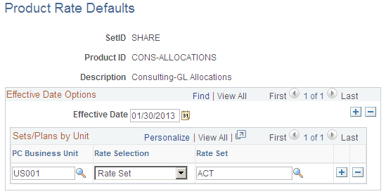

Use the Product Rate Defaults page (CA_PROD_RATES) to define default rate plans or rate sets to the product.
Navigation:
This example illustrates the fields and controls on the Product Rate Defaults page. You can find definitions for the fields and controls later on this page.
Field or Control |
Description |
Effective Date |
Displays the current date. |
Sets/Plans by Unit
Field or Control |
Description |
PC Business Unit (PeopleSoft Project Costing business unit) |
Select a default PeopleSoft Project Costing business unit. |
Rate Selection |
Select whether you want to associate a Rate Set or Rate Plan with the product. The value that you select here determines the additional field (either Rate Set or Rate Plan) that appears on the page. |
Rate Set |
Select a default value for the rate set for the product. This field appears only if you selected Rate Set in the Rate Selection field. |
Rate Plan |
Select a default value for the rate plan identifier for the product. This field appears only if you selected Rate Plan in the Rate Selection field. |
