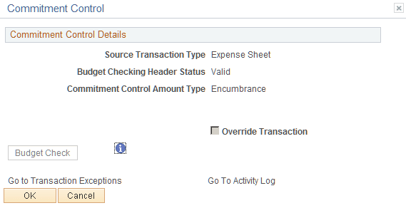

Use the Commitment Control page (KK_EXCPTN_OVER_SEC) to budget check expense transactions online.
Navigation:
Click the Budget Options link on the Approve Travel Authorization - Travel Authorization Summary page using the Manager Self-Service navigation
Click the Budget Options link on the Approve Expense Report - Expense Report Summary page using the Manager Self-Service navigation.
Click the Budget Options link on the Approve Travel Authorization - Travel Authorization Summary page using the Travel and Expenses navigation.
Click the Budget Options link on the Approve Expense Report - Expense Report Summary page using the Travel and Expenses navigation.
This example illustrates the fields and controls on the Commitment Control page. You can find definitions for the fields and controls later on this page.
Use this page to check the travel authorization amount against commitment control budgets and record the amount as an encumbrance.
Commitment Control Details
Field or Control |
Description |
Source Transaction Type |
Displays the transaction as a travel authorization or an expense sheet. |
Budget Checking Header |
Indicates the current budget checking status. |
Commitment Control Amount Type |
Identifies this as an encumbrance transaction. |
Commitment Control Tran ID (commitment control transaction identification) |
Activity log transaction number for the commitment control transaction. |
Override Transaction |
Select to enable the entire transaction to update the control budget, even if error exceptions exist. |
Budget Check |
Click to run the Budget Processor for this transaction. |
Go To Transaction Exceptions |
Click to access the page where you can view budget checking errors or warning messages for travel authorization transactions. Users who have authority can override the budget exceptions on this page. |
Go to Activity Log |
Click to access the Commitment Control Activity Log page, where you can view activity for all lines in a transaction that updated the control budget. |

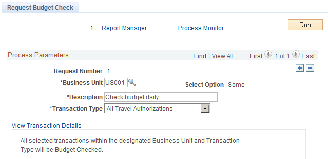

Use the Request Budget Check page (EX_BGTCHK_REQUEST1) to run the budget checking process for travel authorizations, expense reports, and journal expense reports. The Process Scheduler process runs the Commitment Control Budget Processor at user-defined intervals.
Navigation:
This example illustrates the fields and controls on the Request Budget Check page. You can find definitions for the fields and controls later on this page.
Warning! Use different run control IDs for the budget checking processes such as budget check request, cancel travel authorization, and rollover travel authorizations. You must use a unique run control ID for each of these processes.
Field or Control |
Description |
Bus Unit (business unit) |
Select a business unit. |
Description |
Enter a description about the run control. |
Transaction Type |
Select a Commitment Control transaction type. Options include:
View Transaction List |
Click to access the Transaction Details page to select parameters and transactions to budget check. |

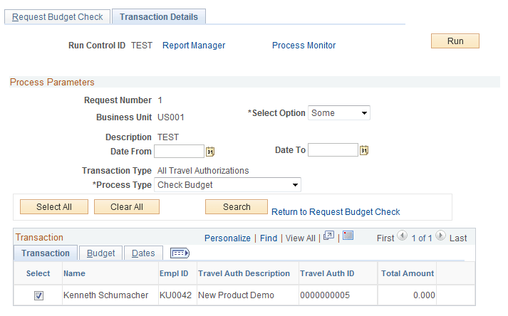

Use the Transaction Details page (EX_BGTCHK_REQUEST2) to select a date range or specific expense transactions to be budget checked.
Navigation:
Click the View Transaction Details link on the Request Budget Check page.
This example illustrates the fields and controls on the Transaction Details page. You can find definitions for the fields and controls later on this page.
Use the Date From and Date To fields to search for transactions that are eligible for budget checking. To enter date criteria, select Some in the Select Option drop-down list box. If you do not enter date criteria, all eligible transactions of the selected transaction type appear in the grid. You can then select some or all of the transactions to budget check. The Transactions, Budget, and Dates tabs display different information related to the expense transactions listed in the grid.
Warning! Do not run the payment staging process concurrently with the budget checking process to ensure that the system does not select the same transaction for both processes.
