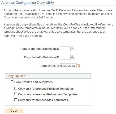

Use the Approval Configuration Copy Utility page (EX_APPRV_COPY) to use the approval setup copy utility.
Use this page to copy approval setup, profiles, and templates from one SetID to another.

This example illustrates the fields and controls on the Approval Configuration Copy Utility page. You can find definitions for the fields and controls later on this page.
The approval framework uses a Definition ID as a key field when defining the Approver Process Definition criteria for expenses workflow processing. To accommodate this change, PeopleSoft Expenses uses Definition ID synonymously with SetID for approval framework setup purposes and copy functionality. All PeopleSoft Expense processing continues to use SetID for PeopleSoft Expenses setup and processing. When using this page, enter your SetID.
Field or Control |
Description |
Copy Profiles and Templates |
Select to copy all of the profiles and templates that PeopleSoft Expenses delivers as system data. This check box must be selected to select any of the referenced templates check boxes. |
Copy only referenced Privilege Templates |
Select to copy only the active privilege templates assigned in approver profiles. |
Copy only referenced Refinement Templates |
Select to copy only the active Refinement templates assigned in approver profiles. |
Copy only referenced Risk Templates |
Select to copy only the active Risk templates assigned in approver profiles. |
