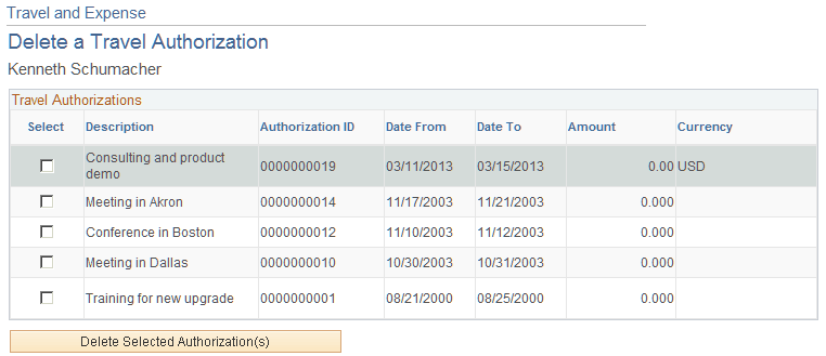

Use the Travel and Expense - Delete a Travel Authorization page (TE_DEL_TAUTH) to delete a travel authorization.
Navigation:
Travel and Expenses Travel Authorization Delete a Travel Authorization
This example illustrates the fields and controls on the Travel and Expense - Delete a Travel Authorization page. You can find definitions for the fields and controls later on this page.
PeopleSoft Expenses displays a list of un-submitted or denied travel authorizations. Use the Select column to select travel authorizations to delete, and then click the Delete Selected Authorization(s) button.
