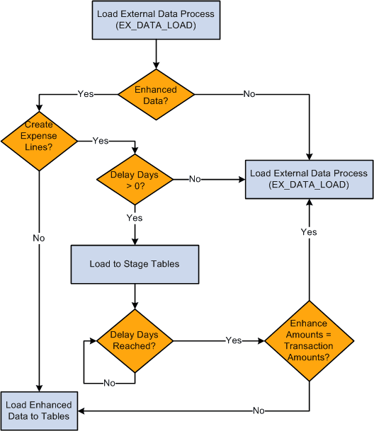

Enhanced Data
This diagram illustrates the process of loading enhanced data, which creates expense lines. PeopleSoft Expenses supports importing enhanced detail data for hotel expense transactions that are charged on a Visa, American Express, and MasterCard credit card. This data is transferred into Expense Report or My Wallet tables. To support this process, you need to indicate whether enhanced data can be loaded into your Expenses application using the Corporate Card Supplier setup component. You also need to map the enhanced data to expense types.
The diagram illustrates these decision points for the Load External Data process:
Is the Data Source Amex (either GL or KR), Visa or MC3.0?
If yes, process enhanced data checks and go to step 2.
If no, run the Load External Data Process.
Is the Load Enhanced data check box selected on the Corporate Card Supplier or the Card Issuer page for the supplier?
If yes, go to step 3.
Is the Create Expense Lines check box selected on the Corporate Card Supplier or the Card Issuer page?
If yes, go to step 4.
Are delay days greater than zero?
If yes, load data into staging tables and go to step 5.
Have the delay days been reached?
If yes, got to step 6.
If no, stop.
Are the amounts on the enhanced data lines equal to the transaction amounts?
If yes, process the lines through the Load External Data process.
If no, do not create expense line. Load the data into the Enhanced Data Detail and Summary tables.
The Expenses Load External Data process loads the credit card supplier file that may contain the main transaction and the enhanced data in the same file. However, the main transaction may come in a file prior to the enhanced data. For example, the main transaction might be sent in a file that a credit card supplier sends on Monday, and the enhanced data is sent in a file that the same credit card supplier sends on Thursday. In this case, the system incorporates the delay days to connect the main transaction with the enhanced data. The delay days is defined on the Credit Card Supplier page.
If the value in the Delay Days field is greater than zero, all hotel transactions are loaded to staging tables This includes the main transaction data, the lodging summary data, and the lodging detail data.
The system retrieves the data from the staging table when the delay days are met. If the detail or summary data equals the total amount of the main transaction record, the data is moved into My Wallet and appears on the My Wallet Detail page. If the detail or summary amounts do not match, only the main transaction data is moved into My Wallet.
