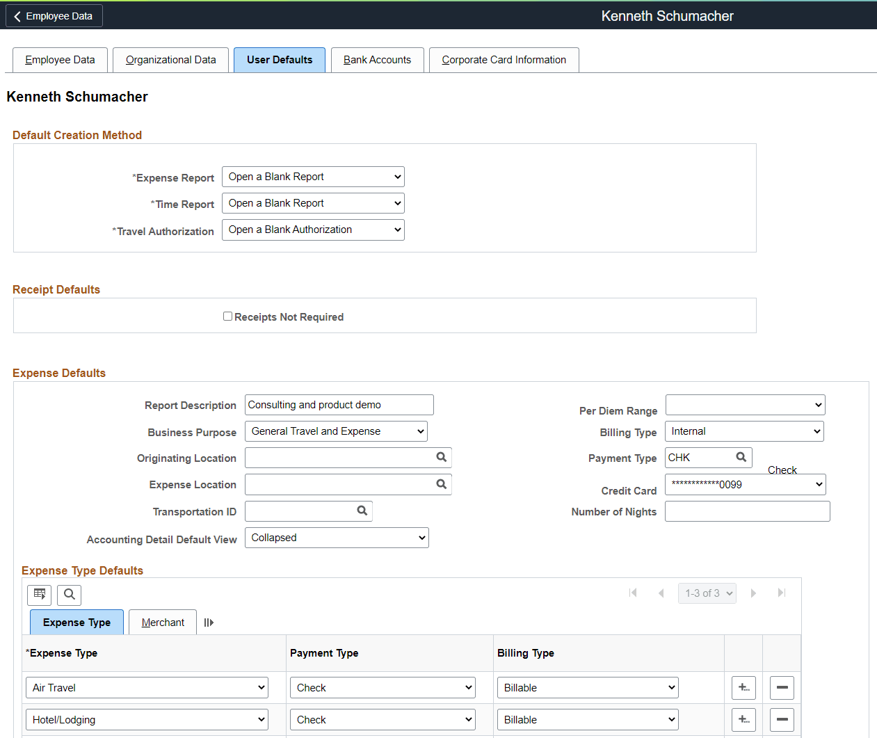

Use the Employee Profile - User Defaults page (EX_EE_USER_PREF) to view or modify general default preferences and default preferences for travel authorizations, cash advances, expense reports, and time reports.
Navigation:
. Select an existing expense report and from the Actions drop down list box, select User Defaults.
This example illustrates the fields and controls on the Employee Profile - User Defaults page (1 of 2).
This example illustrates the fields and controls on the Employee Profile - User Defaults page (2 of 2).
Default Creation Method: Online

Receipt Defaults
Field or Control |
Description |
Receipts Not Required |
Select to indicate that this user is not required to attach receipts to expense reports. This value overrides the Enforce Receipt option entered on the Receipts Required Page for the General Ledger business unit. Note: Only system administrators have access to this field. Individual employees cannot access this field. |
Expense Defaults
Field or Control |
Description |
Report Description |
Enter a description that you want to appear by default onto the header level of your travel authorizations, cash advances, and expense reports. |
Per Diem Range |
Select a per diem range ID that is associated with a range type of Daily. A per diem that is associated with a range type of Daily, on a project or at a site, requires the number of days to appear by default into the expense report for the employee. This field only has values if the user is associated with a SetID that uses a daily range type. Ranges are defined on the Per Diem Range page and the amount for the per diem is defined on the Per Diem Amount page. |
Business Purpose |
Select from a predefined list (created when your organization implemented the PeopleSoft Expenses system). The business purpose that you select appear by default onto the header level of your travel authorizations, cash advances, and expense reports. |
Billing Type |
Select the billing action that you want to appear by default onto your travel authorizations, expense reports, and time reports. If you use PeopleSoft Project Costing, billing codes are required to identify project costs that are both billable and charged to project costing ChartFields. PeopleSoft Expenses passes these items to PeopleSoft Billing for processing. |
Originating Location |
Select a city, country, or geographical area (established by your organization during system setup) that you want to appear by default onto your travel authorizations and expense reports. |
Expense Location |
Select a city, country, or geographical area where you will incur expenses that you want to appear by default onto your travel authorizations and expense reports. |
Payment Type |
Select how you pay for expenses and enable the payment type to appear by default onto your travel authorizations and expense reports. Note: A payment type must be selected if you are creating a Travel Authorization using PeopleSoft Fluid. For more information, see Creating Travel Authorizations Using PeopleSoft Fluid |
Credit Card |
Select a credit card number that you want PeopleSoft Expenses to use as a default for expense transactions with a method that may directly reimburse the vendor. For security reasons, all but the last four numbers for each credit card will be masked. The credit card information for the employee is maintained on the Employee Profile - Corporate Card Information page. |
Transportation ID and Transportation Type |
The system displays the employee's active transportation IDs from which to choose. Select a transportation ID that you want to appear by default onto your travel authorizations and expense reports. |
Number of Nights |
Enter the number of nights that you want to appear by default onto your travel authorizations and expense reports for the expense type Hotel/Lodging. |
Accounting Detail Default View |
Select Collapsed or Expanded to indicate how the Accounting Detail section should appear on the expense report when the expense type is selected. |
Expense Type Defaults - Expense Type Tab
Field or Control |
Description |
Expense Type |
Select an expense type. When you select the expense type on your travel authorizations and expense reports, PeopleSoft Expenses will populate the payment type, billing action, and merchant information. |
Payment Type |
Select how you pay for the expense type. When you select the expense type on your travel authorizations and expense reports, PeopleSoft Expenses will populate the Payment Type field with this information. |
Billing Type |
Select the billing action that you want to appear by default onto your travel authorizations and expense reports for the expense type. If you use PeopleSoft Project Costing, billing codes are required to identify project costs that are both billable and charged to project costing ChartFields. PeopleSoft Expenses passes these items to PeopleSoft Billing for processing. |
Expense Type Defaults - Merchant Tab
Field or Control |
Description |
Preferred Merchant or Merchant |
Select a preferred merchant or a non-preferred merchant. When you select the expense type on your travel authorizations and expense reports, PeopleSoft Expenses will populate the Preferred Merchant or Merchant field with this information. Note: You may select a preferred merchant, a non-preferred merchant, or neither; however, you cannot select both. |

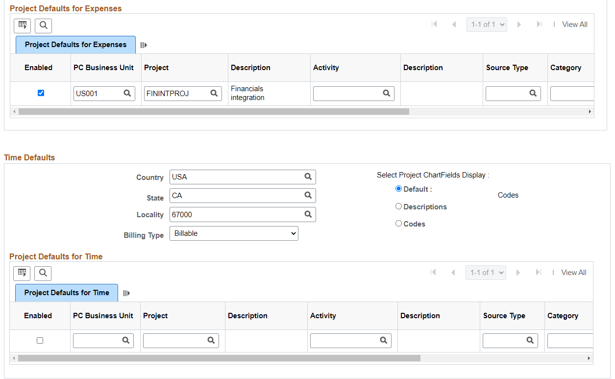

Project Defaults for Expenses
Field or Control |
Description |
Enabled |
Select to indicate to the system to include the project as a default on travel authorizations and expense reports. |
PC Business Unit |
Select a business unit for a project that you want to appear by default onto your travel authorizations and expense reports. |
Project and Description |
Select a project that you want to appear by default onto your travel authorizations and expense reports. |
Activity and Description |
Select a project activity that you want to appear by default onto your travel authorizations and expense reports. You create activities in PeopleSoft Project Costing. |
Percentage |
If the project is enabled, enter a positive, non-zero amount less than or equal to 100. The sum total of all enabled projects must equal 100 percent. Note: PeopleSoft Expenses does not display this field if PeopleSoft Project Costing is not installed. |
Source Type, Category, and Subcategory |
If applicable, select for which you want to record time. If you enabled the project default line, PeopleSoft Expenses uses these entries to create the default accounting distribution for travel authorizations and expense reports. |
Note: Access to these fields is determined by the value in the PC ChartFields field on the Employee Privilege Template Page for the expense report transaction.
Time Defaults
Field or Control |
Description |
Country, State, and Locality |
Select a country, state, and locality (established by your organization during system setup) that you want to default onto the header of your time reports. |
Billing Type |
Select the billing action that you want to default onto your time reports. If you use PeopleSoft Project Costing, billing codes are required to identify project costs that are both billable and charged to project costing ChartFields. PeopleSoft Expenses passes these items to PeopleSoft Billing for processing. |
Select Project ChartFields Display: |
Select how you want PeopleSoft Expenses to display PeopleSoft Project Costing ChartFields displayed on your time reports. Options are:
Project Defaults for Time
Field or Control |
Description |
Enabled |
Select to indicate to the system to include the project as a default for time reports. |
PC Business Unit |
Select a business unit for a project that you want to appear by default onto your time reports. |
Select a project that you want to appear by default onto your time reports for which you want to record time. |
Select a project activity that you want to appear by default onto your time reports for which you want to record time. You create activities in PeopleSoft Project Costing. |
Time Quantity |
If the project is enabled, enter the number of hours per day, per project to appear by default onto the time report. You cannot exceed 24 hours on a single enabled row and you cannot exceed 24 hours for an accumulated total of all enabled rows. Note: PeopleSoft Expenses does not display this field if PeopleSoft Project Costing is not installed. |
If applicable, select for which you want to record time. If you enabled the project default line, PeopleSoft Expenses uses these entries to create the default accounting distribution for time reports. |
Note: Access to these fields is determined by the value in the PC ChartFields field on the Employee Privilege Template Page for the time report transaction.
