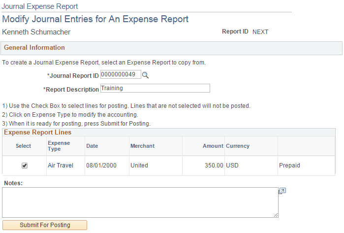

Use the Modify Journal Entries for An Expense Report page (EX_SHEET_HDR_JRNL) to create journal expense reports to correct errors and make adjustments to expense report payments to synchronize the expense system and general ledger.

This example illustrates the fields and controls on the Modify Journal Entries for An Expense Report page.

Field or Control |
Description |
Journal Report ID |
Enter the original expense report ID that requires an adjustment. Available report IDs are those that are associated with employee IDs for whom the auditor has entry authority. |
Report Description |
Enter a description for the journal expense report. |
Expense Report Lines
Field or Control |
Description |
Select |
Select lines to post. Lines not selected will not post. |
Expense Type |
When you select an expense report ID, the system displays all line items in that report. To view or correct accounting information for a line item, click the link to access the Journal Expense Report - Accounting Detail page and modify the accounting for the expense. |
Date |
Displays the date of the original transaction. |
Comments |
Enter comments about this journal expense report. |
Budget Status |
If you use PeopleSoft Commitment Control and budget checking for expense reports is active, PeopleSoft Expenses displays the budget status for the expense report. |
Budget Options |
Click the Budget Check Options link to access the Commitment Control page to budget check the travel expense or view comments about the budget check. This link is available only if you use PeopleSoft Commitment Control and budget checking for expense reports is active. Note: If you make any changes to distributions or amounts, you must budget check the expense report again to reflect the changes in the commitment control ledgers. |
Submit For Posting |
Submit the journal expense report for processing. |
